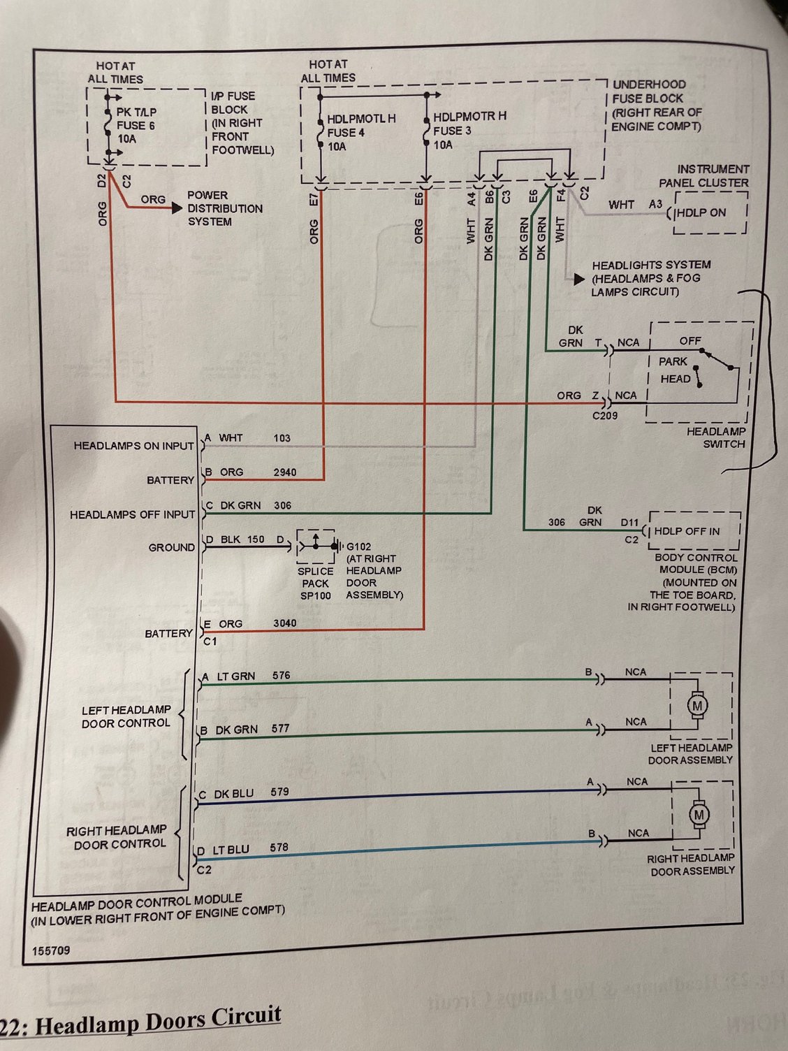

Hi Tony, thanks for your suggestion. Probably not viable to ship the part you mention back to the USA from Australia. Looking back now at what happened immediately prior to discovering the issue, I had just reconnected the under hood emergency light that the previous owner had disconnected, (it’s now working) and secured the main headlight connector cluster back onto the little clip on the inner fender. Looking at your wiring diagram and wondering if Headlamp Door Control Module might have a bad ground ? I guess it’s going to be a process of elimination to find the fault.

Ah yes, that’s a bit of a trip! You can check for 12vdc on terminal A on the connector for the headlight door control module with parking lights on. If you have voltage, I’d assume an issue with your headlight switch. If no voltage, definitely a control module failure.
Off sends 12v to close the doors, On sends 12v to open the doors. Parking lights on is a dead band for the doors with no movement.
