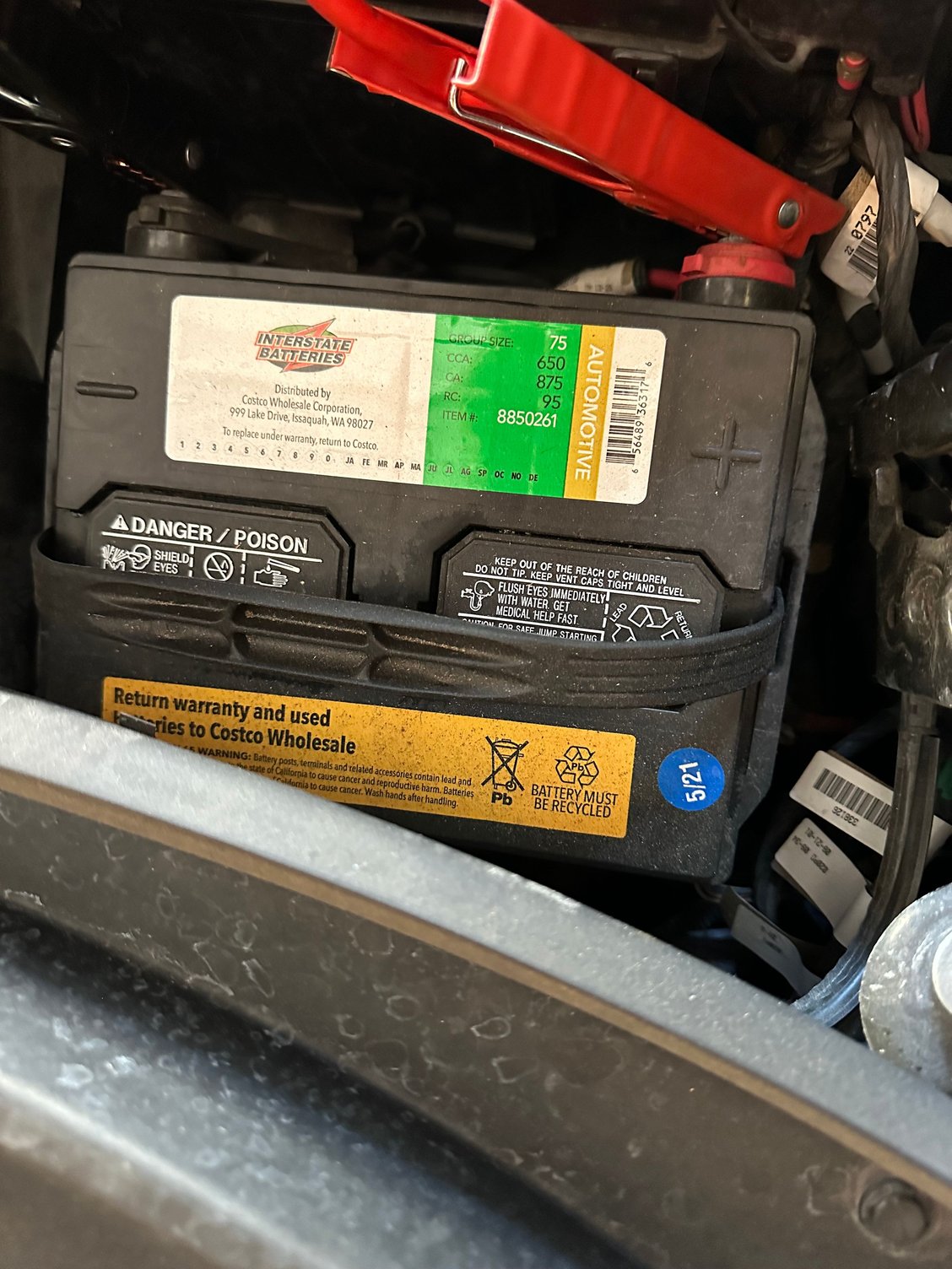

Battery starts strong but drops fairly quickly. Today it was only getting 11.5v on the guage, while hooked to jumpers
never looked on display
date code is 5/21

Could very well be the battery, have it load tested. If your car does have a true no comms problem it will crank but not start because the various modules all communicate on a single wire and if that network fails the PCM and BCM will not allow the car to start.

I guess I just never thought it would be the battery since it sits on a tender but the fact it does so quickly when cranking makes me suspicious. I’ll get it tested

11.5v is less than 20% of a 'fully charged' battery (this is one example, chart is a little ways down the page). Load test should tell you what you need to know. If it's questionable I'd start by replacing the battery first. If you're still having trouble after that at least you've eliminated one potential source of the issue.

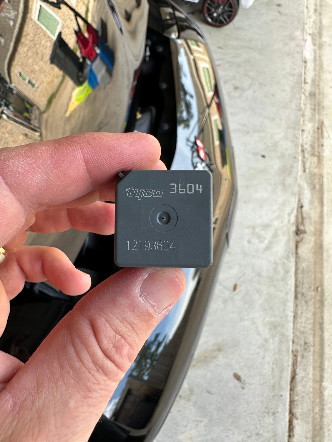

Swapped in a new relay and fired up like nothing ever happened.

Well I thought it was fixed
went to start it over the weekend and first it immediately went dead.
I've had an issue with the ground on the battery not tightening all the way for some time. I got out messed with it and power instantly restored.
however all it would do is crank, not fire. Then I heard the IGN relay making the buzzing sound just like before.
Figured that maybe the loose battery ground caused all this.
I went ahead and FINALLY replaced the bolt. Also ordered a new IGN relay.
installed both yesterday but still won’t fire, just cranks.
I plan to check the rest of the fuses and relays but other than that, I’m at a loss.
