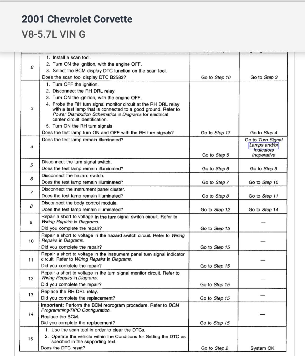

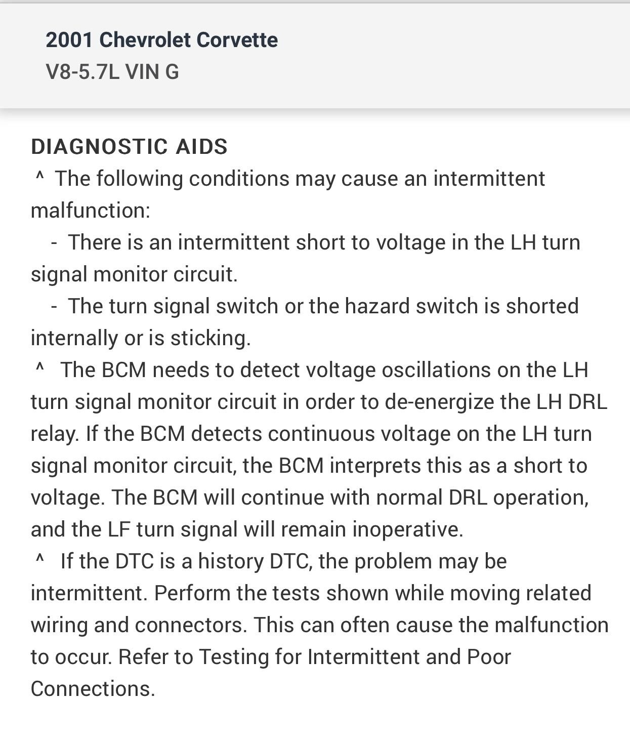

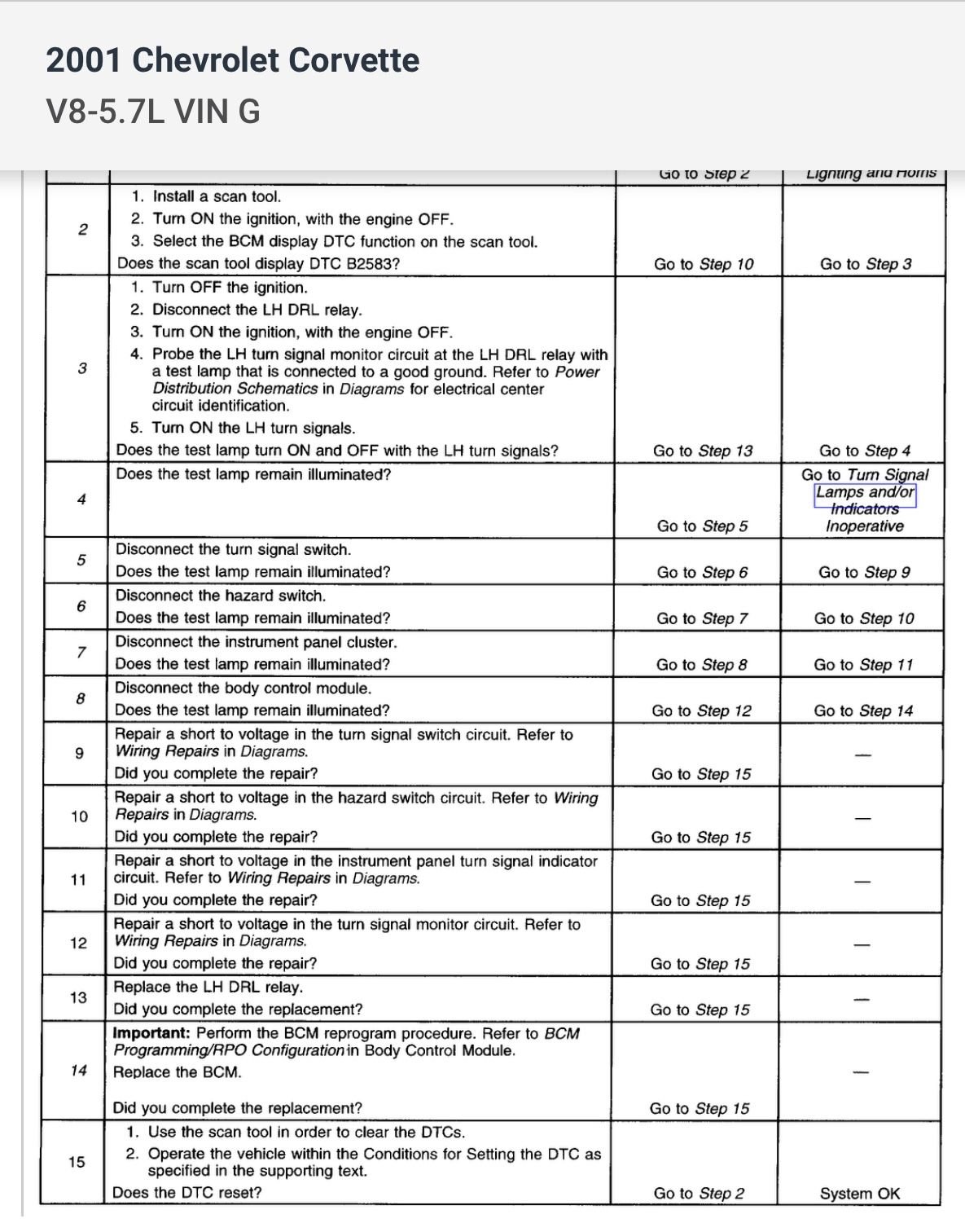

You can use your multimeter to do voltage drop checks on the wiring circuit…many YouTube videos about voltage drop testing if you don’t know how to do it…below is how to diagnose your 2 DTC’s.

PS. I did have a couple of questions about the useful tables that you included in your post...
- What is the first row that's missing from the images?
- Is the first column to the right of the directions 'Yes' and the second one 'No'?
- When it says to install a 'scan tool', does it mean a proper diagnostics tool e.g. Tech2, or does the on-board tool work? I've not got a proper diagnostics tool yet, but maybe that would be a good plan. Will have to search the forums for advice on suitable ones that are available in the UK.

Great !!…yes, left column is yes and right is no on this logic tree…they mean a Tech 2 when they say connect the “scan tool”…you can use a bidirectional scan tool in lieu of the Tech 2…I personally don’t like using these troubleshooting trees especially when it comes to electrical checks…GM has you using resistance checks with an ohmeter when you should be using loaded circuit testing using voltage drop testing…I guess the GM Engineers should have consulted people that actually know how to test electrical circuits.
