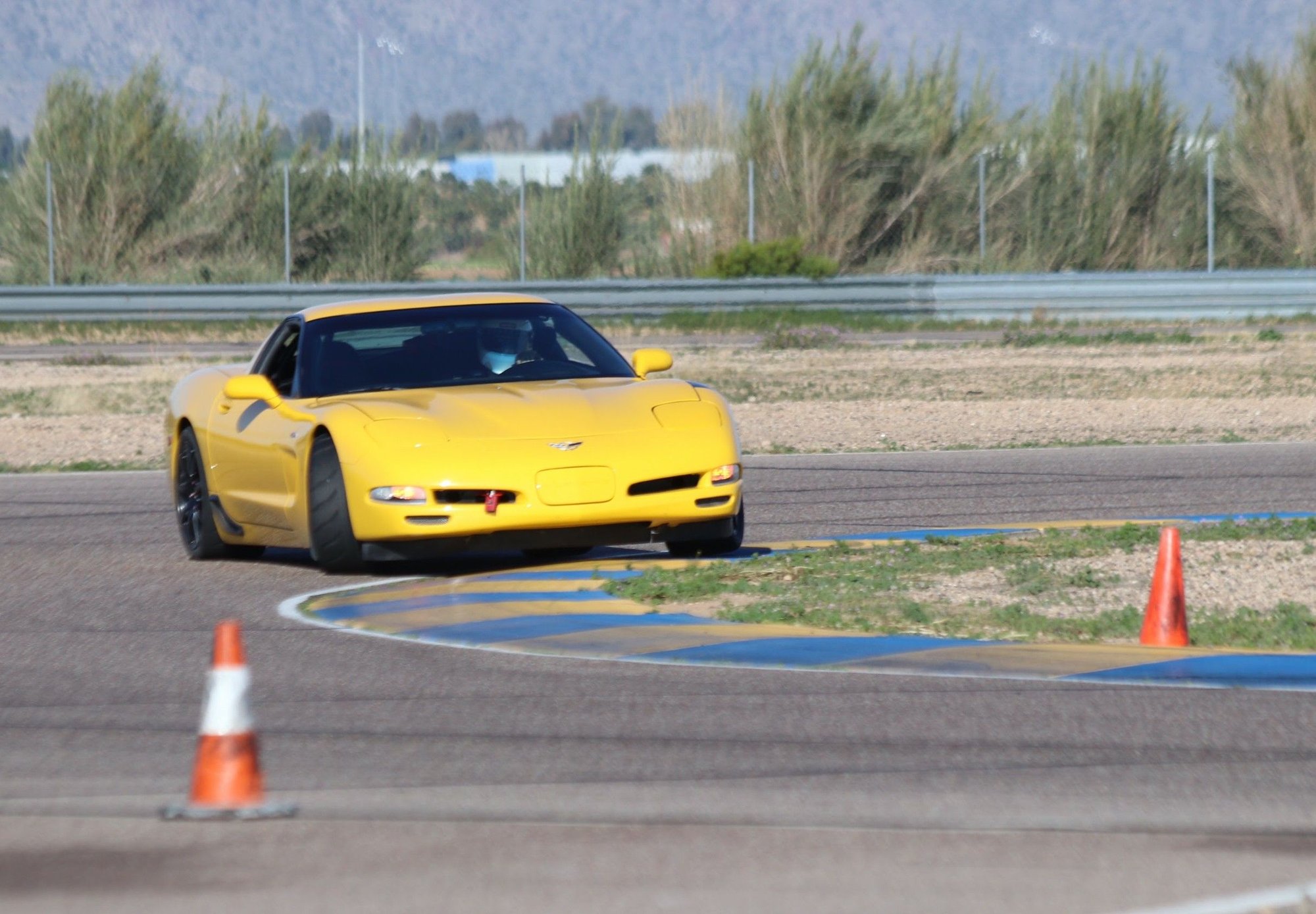

This is me during my "rookie" first season. Turn 8 @ AMP. This progressed into a "Tank Slapper" but I managed to keep it on track and in the proper direction! That turn kicked my *** for several track days but once I figured it out (very late apex) my times and confidence improved dramatically.

Hanging it out to dry on 888r's! Nice
