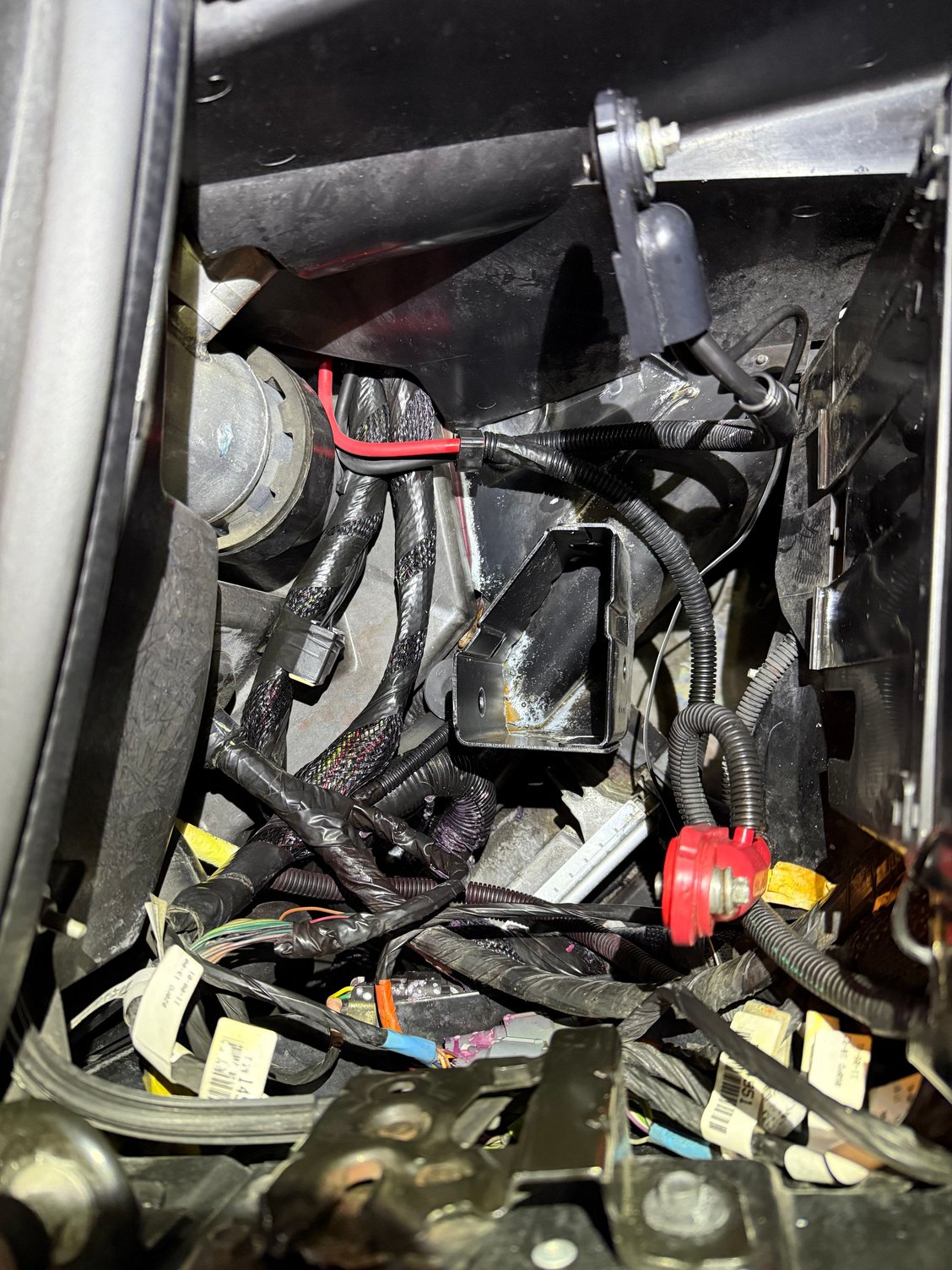

If you do get a new battery and you have a DVOM and know how to use it I’d check to see if the battery is not overcharging.

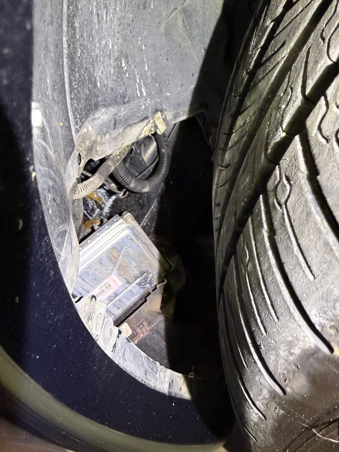

Posts: 205
Likes: 45
just cleaned the area with CRC battery cleaner and definitely was a bunch of acid in many places as the foam turned red to indicate presence of the acid. I’m going to do it one more time tomorrow.
do you think I need to access the pcm from the wheel well also or is cleaning from above sufficient?

Dads2kconvertible's Avatar
Dads2kconvertible
Joined: Sep 2021
Posts: 2,555
Likes: 1,213
I'd be pulling battery and battery tray to clean underneath the battery tray. There is an electrical box underneath it and if battery acid gets in there and corrodes things you'll have a huge mess years from now.

Espi2's Avatar
Espi2
Joined: Nov 2024
Posts: 205
Likes: 45
that’s exactly what I did this afternoon - will be painting some tomorrow to cover up a bit of the paint that came off the frame. My concern is it was leaking under the car a bit so wondering if there are other areas I cannot see.

mmartinez's Avatar
mmartinez
Joined: Sep 2008
Posts: 3,133
Likes: 802
From: Espanola New Mexico
I would remove the wheel well cover and inspect the pcm and it's connectors as well as the TAC module. You want to make sure no acid made its way to those connections.

Espi2's Avatar
Espi2
Joined: Nov 2024
Posts: 205
Likes: 45
ok - will do that in the morning. Thanks.
