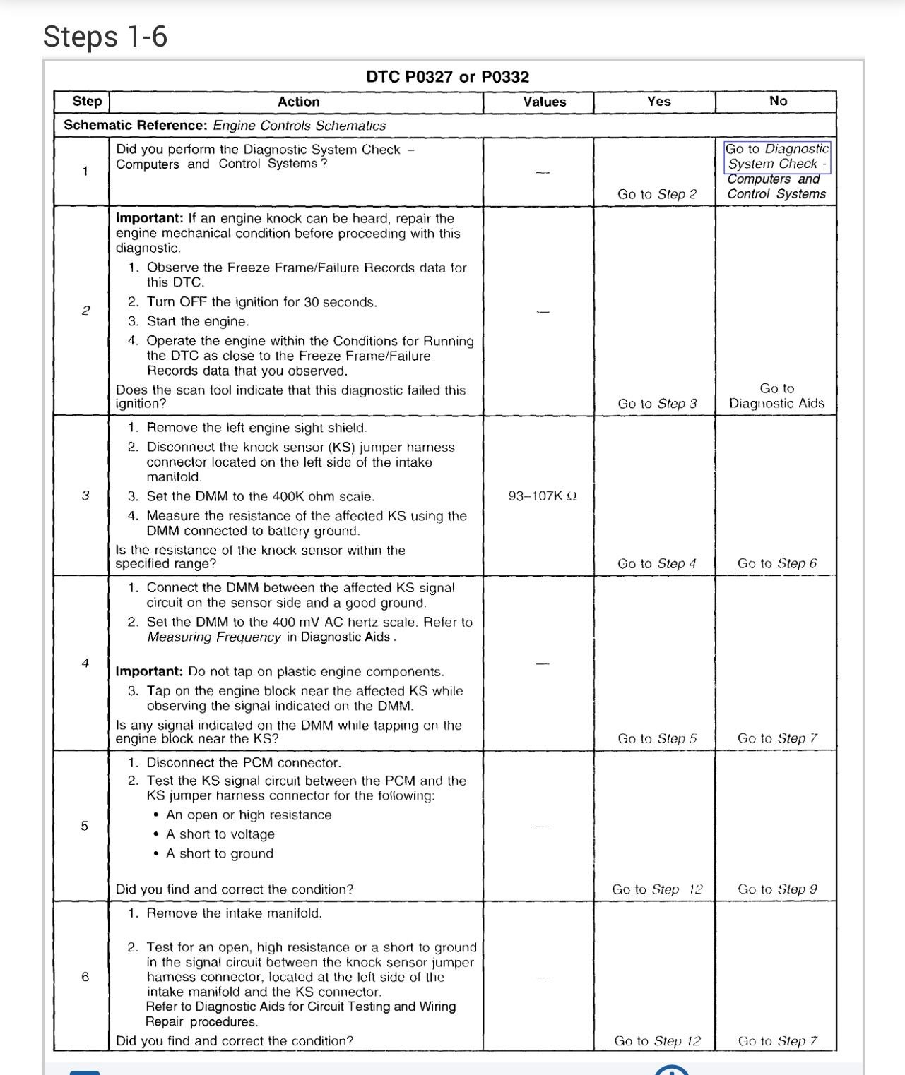

There is a fairly detailed troubleshooting procedure in the service manual. I would start there.
Old Dec 10, 2024 | 04:52 PM
C5 Diag's Avatar
C5 Diag
Moderator, Tech Contributor
Posts: 15,539
Likes: 4,018
From: Cape Coral, Florida
