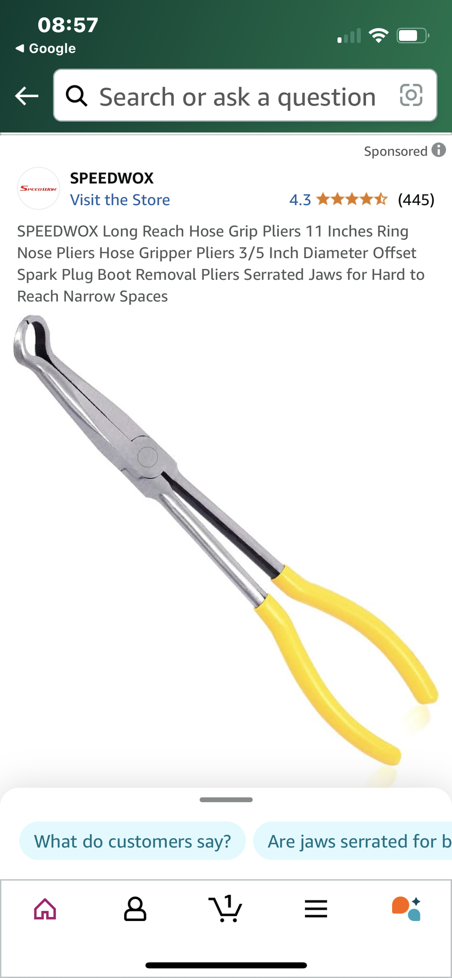

You need one of these

The plyers above are what you need. Note they can be purchased in different angles and lengths. Choose what you need.
You get in under the metal shield and it will pull the boot off. Beware it is not uncommon to have the wires break. They get brittle. and can and will pull apart even using care.

Never needed anything special before but I think the recommendation from the "Captain" to pickup a Speedwox Long Reach would be nice insurance.
