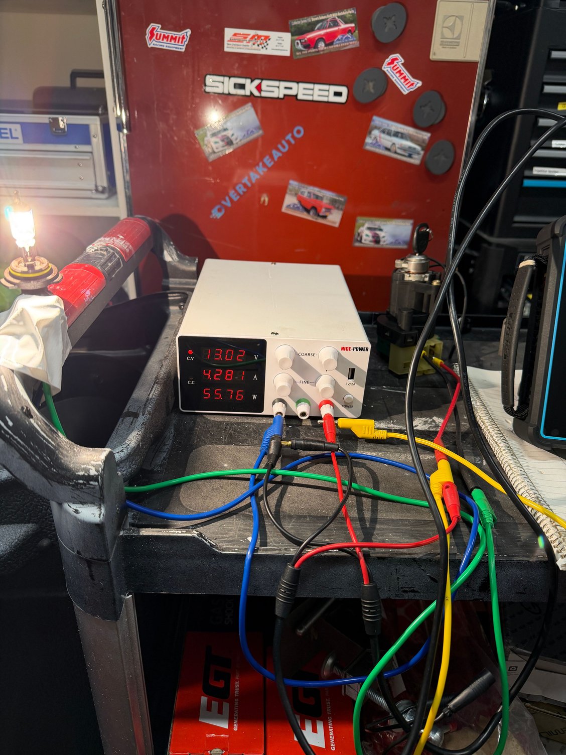

Just for fun I removed the ignitionswitch for the car and loadtest on my workbench with å powersupply and a load (lamp)
Currentdrop less then 0.2 volt over the OLD IGN swith . (approved)

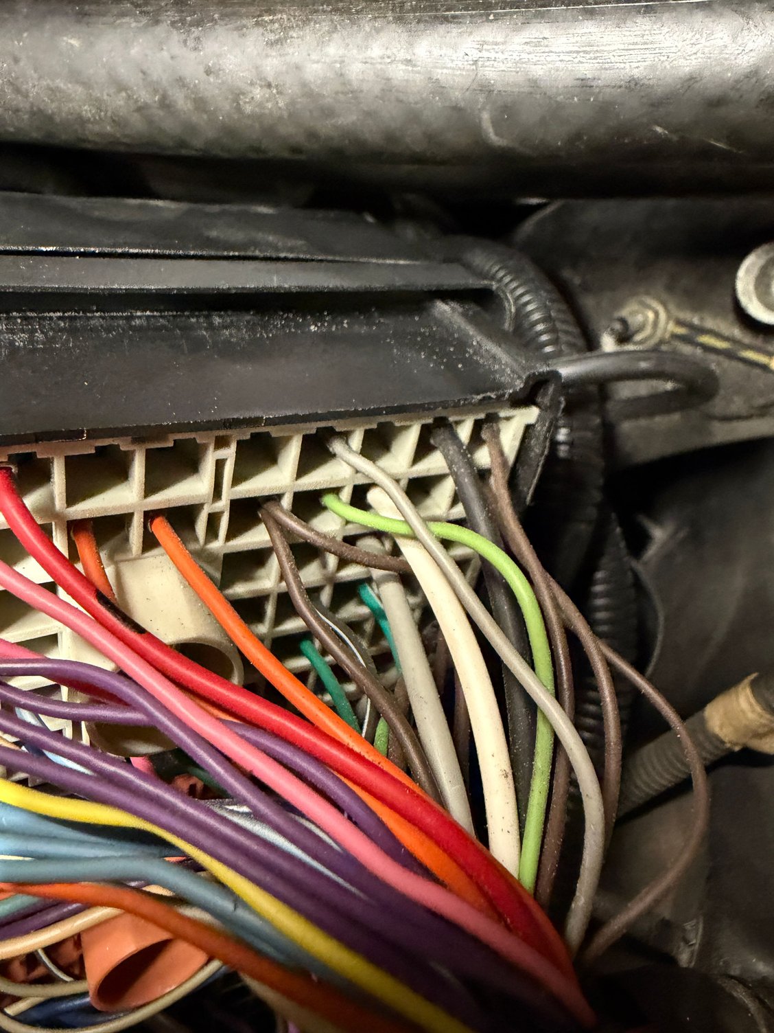

I then inspected the underhood fusebox MiniFuse 5 fuselocation with the brow wire going to the Pin A of the EBCTM connector.
It was hard to get less then 0.3 ohm resistance in this brown wire include fuse and pin connectors .
I the opened the EBCTM and corrected the spring mechanisme in the pin , cleaned it Deoxit and put everything back together .
I was now able to measure 0.000 ohm between the connector and MiniFuse 5 fuseconnector.
Put the battery back in the car put power on my pin A using the ignition switch.
I also verified my scope channels reading against a powersupply and saw it was some minor difference .
Last measurement shows a drop of approx 0.3 volt between battery positive and Minifuse 5 (underhood) and a 0.16 vol between MiniFuse 5 and EBCTM pin A .
