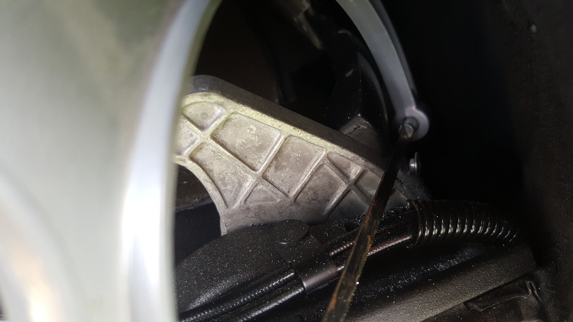

I had planned on getting new straps from the dealer but I re considered figuring that they would stretch out like the originals did.
So I went to Walmart and bought two flat bungee straps (24")
I then used a hack saw to remove the current rivets after pulling the factory straps off, I then used a screw/bolt combination to attach the new straps to the top.
I then cut the straps to the exact length of the old factory straps, I figured this would give me room to hold the strap as I screwed them into the bottom holes...those holes are a real bit** to thread into!
There are a few more little details but that is the short version and is to the point enough. I will say that this is by no means an "easy" job, I've done much more difficult things but many more easier as well. Its not for the faint of heart, if you don't feel you can complete it don't try, no straps at all is far worse than stretched out ones!!
If you have this issue and live in Southern Florida PM me, I can help you out.

Cutting the rivet out wasn't difficult, I was going to replace it with another rivet however the rivets I have were not long enough.
Another note, I burned the ends of the strap so that they wouldn't come apart.
The top operated beautifully now!
