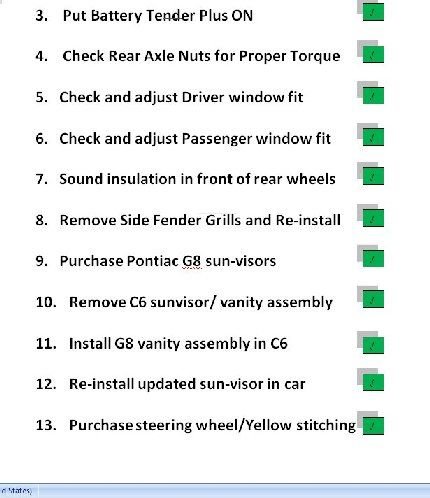

Congratulations on completing your projects. It is satisfying when you do it yourself
Each fall, when I put my car away, I make a spreadsheet with all the projects or work I want to do or check over the winter.
Sometimes it just simple stuff, but other times it's more complex and difficult.
Here is a small sample of what I had on the list this winter. Mostly simple stuff this year.

Love the list! Why the change to the G8 visors?

Because of the weak vanity mirror covers, I have replaced 2 passenger sunvisors since the original, and one of the hinges was already broken on the 3rd last fall. The G8 visor vanity mirror assembly is a bit wider, but has sturdy mirror covers, much like other newer GM vehicles.
I'm not sure why the C6 cover hinges were made of a thin plastic to begin with. When they get cold, they are easily broken...at least by my passengers who shall remain nameless .
Here is the C6 visor with the G8 assembly installed, and with LED's.
