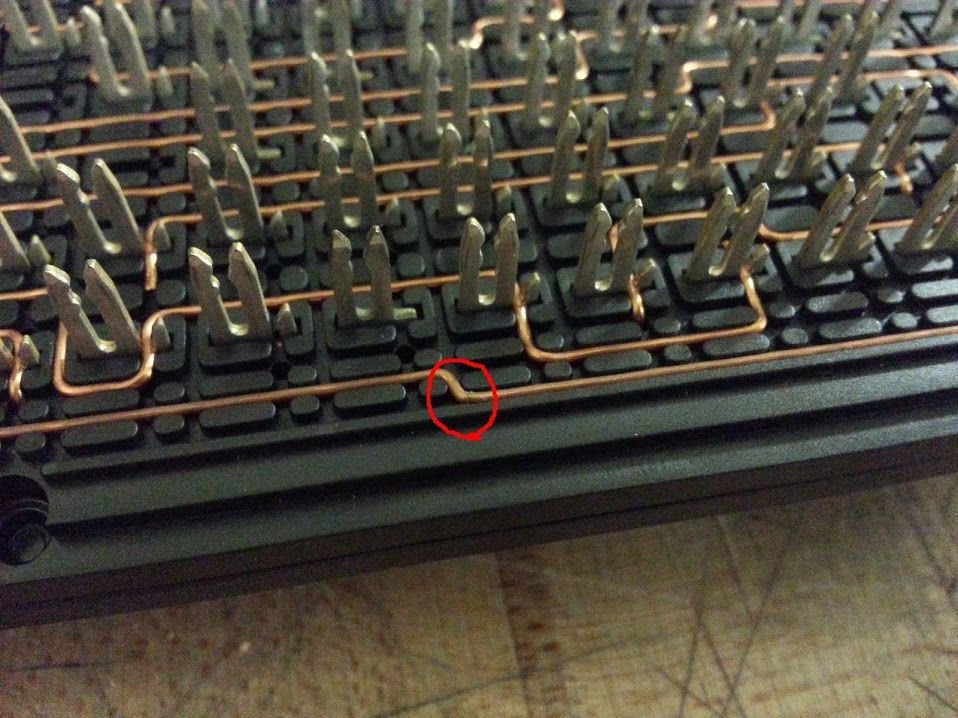

When driving at nite with low beams lites sometime blink also when going over bumps. This is intermittent could something is loose. Thanx for any help in advance. Jay

Have you had the low beam recall done yet? There is a break point in the ground wire for the low beam headlights that will separate when the fuse box gets hot, and the low beams will go out.
Please see attached low beam recall PDF file

Some people with older cars have had worse issues afterwards because of the taking apart of the fuseblock and have more loose or broken connections.
It's a roll of the dice, but if yours are actually bad then it is a worthwhile gamble that the jumper will fix it without any other trouble.
