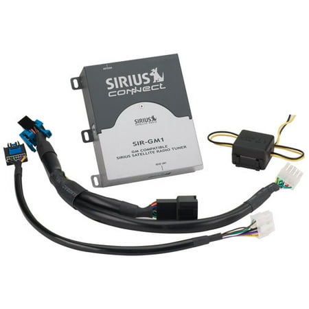

Up to/just before the 2010 models, since sirus bought out XM radio in 2008, the OEM XM module in the car has to be reprogrammed to receiver the sirus signal.
If you bought the used car from a GM dealer, they would pull the module and send it to Sirus to be upgraded, and the dealer would give you free 6 month of sirus to make sure it was working/get you hooked on sirus to begin with.
If the module was not updated, and you need it updated now, and it cheaper to just buy the sir-gm1 module to swap out with the other OEM module that may need to be reprogrammed instead. If you check around, can find them for around $50 new, while the last time I check, sirus wanted something like $80 to reprogram the old xm module to receive there signal.
The sir-gm1 module kit will come with the needed pigtails so you can pull the old module, install the new one right back in the same area, and use the pig tails that comes with it to plug right back in the factory wiring harness.
One the module is isnstalled, then switch to XM to get the serial number from the new module, and that is the one that you need use for the account.
If the module is upgraded/programmed correctly to start with, then time to start checking to make sure that everything is in place. Hence could be that someone disconnected the module, has a Pal in line or swapped for for the XM module, or something happened to the mirrors, and they where replaced with ones that don't have the XM antennas.

To get it updated to receiver the sirus signal is still programmed for XM radio instead, the unit has to be back to sirius, and they will want money to reprogram it. So give them a call, go over the module number on the unit, and check to see if they have any record of it being upgraded (either by its vin number or the cars vin number). Again, if you buy the used car from GM, then will pull the unit, send it to siruis to be upgraded for free, then when they get it back, will install it back in the car, and dealer will set up a 6 month account for free, since they need such for testing to make sure it working. If you have not figure this out yet, XM first gave GM the modules for free to push the service, then when siruis bought out XM, siruis is the one that supplied the XM modules to GM for free next (including upgrading all the older XM modules as well).
IIRQ, sirus wants around $80 to upgrade the older XM radio modules if you send it in yourself, and then you still have shipping back and forth on your dime.
As for the Sirus SIR/GM1 kits, they are harder to find now. Hence it not just the module that you need, but the jumper pigtails that comes with the kits as well. Hence the only ones that I'm finding are the two on ebay, and they do not come with the needed jumper pigtails to being able to connect it to the factory wiring connectors.
Regarding the oem XM C6 modules for sale on the cheap (GM22729350) that may be sirus programmed , I'm not seeing any that show the Sirus update sticker/writing on the labels on them, so could be in the same boat since the ones that I seeing are out of pre-2010 cars, without the sirus update as well.

Go talk to a GM dealer and work it out with them to send it back to Sirus to be reprogrammed (from XM radio, to Sirius). Something may have changed with GM now able to flash the module still in the car, but as of last year, they still have to pull them to send them to sirius to be reprogrammed, then would reinstall them back in the car once they got it back. If you sweet talk the dealer, may end up hooking you up with the free 6 months subscription as well.
Short of that, they you trying to find a Sir-gm1 kit with the needed jumper pigtails, so you can swap it out with the XM radio programed OEM module in the car or another XM module that does have the sirus update on it so you can install it instead. Again, the glitch here, of the $40 used XM modules (GM22729350 I do see up for sale, none of them are showing signs of the siruis updates, so would bank from 2009 cars or older, and the reason that they are going so cheap for the $40 isntead.
