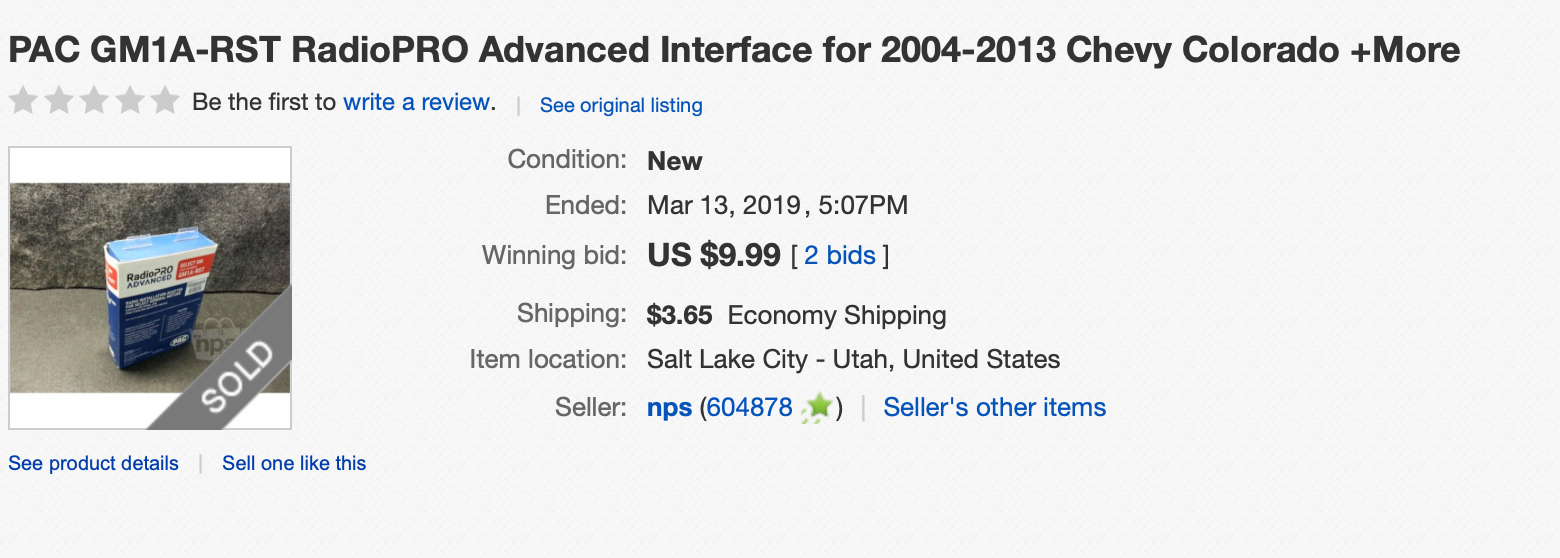

Huh, sorry to hear you've had issues with them, mine has worked just fine with the exception of properly programming the phone buttons, but of course I just installed the steering wheel with controls so I haven't messed with it a whole lot. They've recently came out with a new interface, and I came across one on an internet auction site and managed to pick it up for $10 that I want to try also to see if it works better as far as programming, I'll let you know how things turn out when I get it. Here's the new one they came out with. https://pac-audio.com/catalog/radiop...faces/gm1a-rst
Here was my winning bid on it.
