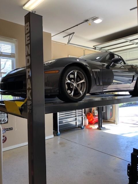

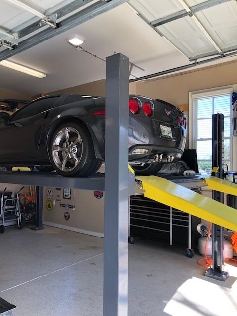

Here's what I use......I just got it recently and highly recommend it! I've been wanting one for years and finally did it, well worth it. Totally beats crawling around on the ground under the vehicle!
