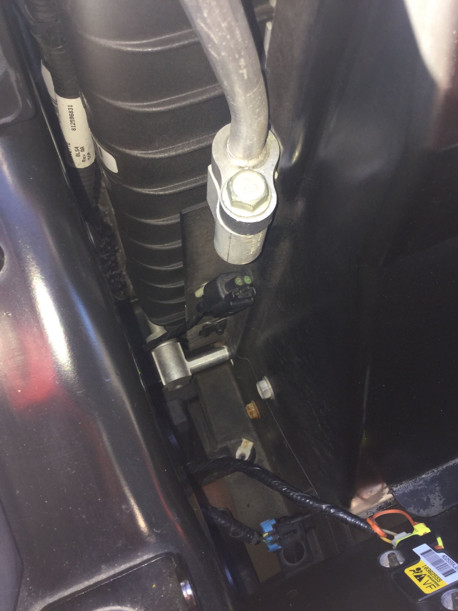

Originally Posted by 919cw313
AFAIK the factory installed light was discontinued after 2006 MY. I don't think they ever got rid of the connector though. Some have installed them on later years, usually along with the crossed flags hood liner. That said, the light is mostly useless and you're better off with a flashlight.
Nope it's still there. My 2013, right side of radiator.
