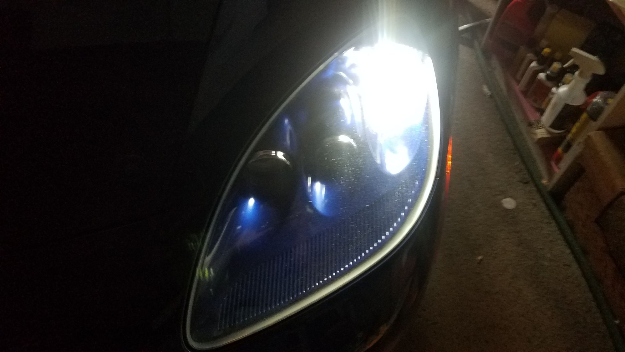

Did this mod the other day and have to say that on the 05, the mounting screw is too short due to the frame being a double piece. Had to get a longer screw.
It's supposed to be a subtle change to the car's look, but it really really alters the daytime look of the C6. The amber
DRL's just look so dated
Curious if you mounted it here?
Old 05-19-2019, 07:25 PM
SladeX
SladeX's Avatar
Member Since: Aug 2014
Posts: 2,496
Received 833 Likes on 607 Posts
I mounted it on the first hole, 2nd one not really accessible. Curious on the spot where you mention, its shaped in back like a ], except its really hard to get my fingers to that spot as the recessed portion increases towards the inner hole. Then where the plug is mounted on the frame, I have a 1 inch lip on there L-shaped which has the connector flat side aimed at ground.
All in all, a bit of a pain to mount, but more an oddity of the 05 design.
