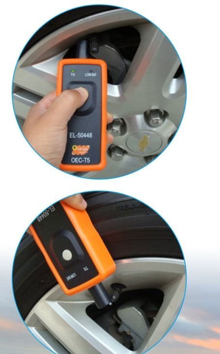

Put on a set of different wheels and tires. Now have to reprogram the sensors. I see the tools any where from about 15 dollars to almost 300 dollars. What is a decent one to use. Not going to be doing this all the time so it will most likely be a tool that is used a couple times a year if that.

I purchased the cheapest TPMS relearn Tool and I have reprogrammed many C6 sensors without any issues.
They are all over ebay for cheap (punch in EL-50448 )and you get many come up at various price ranges. It depends how fast you want it shipped to you as for the price difference.

I just used this same orange tool 4SUMERZ posted, cost $15 bucks and worked great; it did seem to get hung-up on certain tires so took me a few tries, but if you just give it a minute it seems to eventually beep the horn. Its super easy just put car in accessory mode then hold both lock and unlock buttons on fob at same time until horn beeps - then start at front driver wheel and push button on orange tool, wait a minute until horn beeps then move to passenger wheel etc. - go clockwise and on last wheel the horn beeps twice and your done, thats it, piece of cake.

EL-50448 13.99 with 1 day shipping Amazon Prime. If its working for you I'll go this way. Thanks

Same, I bought the cheapest EL-50448 I could find on Amazon. I used it every autocross this year. Works great with no issues.

I don't know if I just got a bad tool but the low Bat light flashes. I have tried 4 different batteries all tested good with my multi meter. Read some online reviews and some of these are bad from the start. I ordered another one and will return this one.

Bingo! The new one came in today and I installed the battery and no flashing Lowbat light. I think this one is the newer version 50448 as it says VXDAS on it. Anyway these wheels put the valve stem in the middle of the wheel. The two fronts were able to be done from the sidewall. The rears being wider I had to go through the tread part of the tire. Had to orientate the tire so the sensor was able to be read through the tread. It is all good now. Final wheel got the two beeps I'm good to go. The bad unit will be returned to Amazon.
