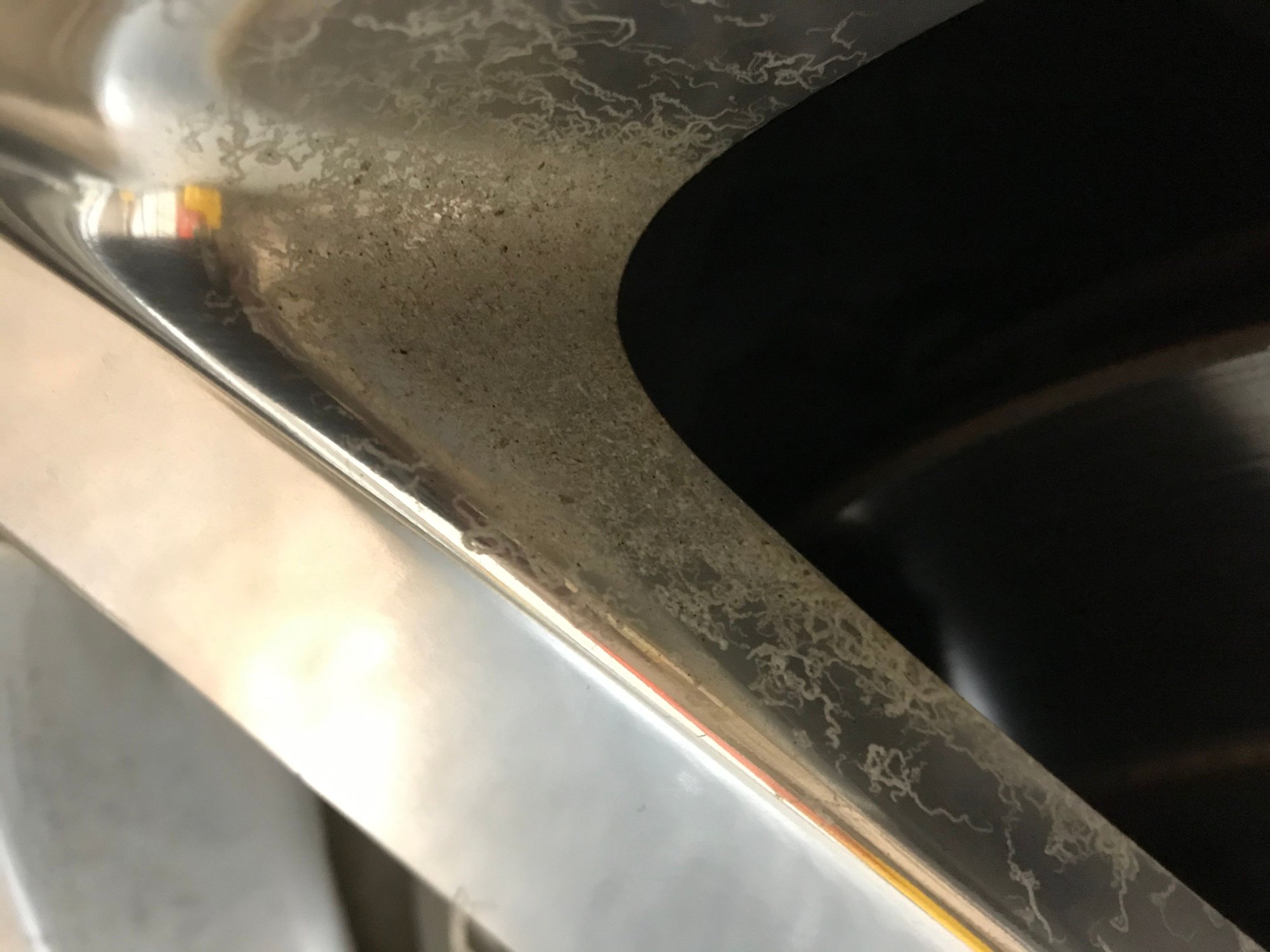

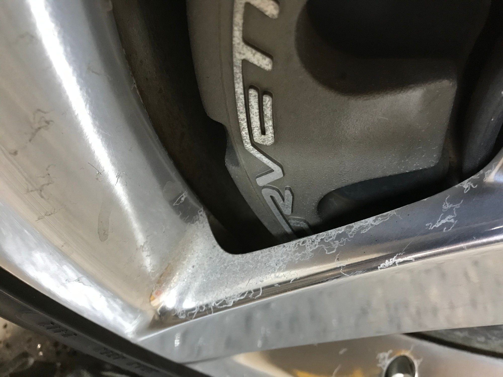

What is going on with my aluminum ( clear coated ) wheels? Looks like they where attacked by spiders.

Brake dust damage?

It looks like the clear coat was exposed to some kind of corrosive chemical. I think the only way to correct it, is to strip the remaining clear coat off, re-polish the wheels, and give it a new clear coat!

If you use a wheel cleaner it’s probably acid based to cut the brake dust. That eats into the clear coat.

Most likely as already stated, a wheel cleaner that was not correct for clear coated wheels. You can remove the clear coat and polish them or have it done. There are wheel restores that can do it. Check with your local GM dealer many use them to correct damaged wheels.
