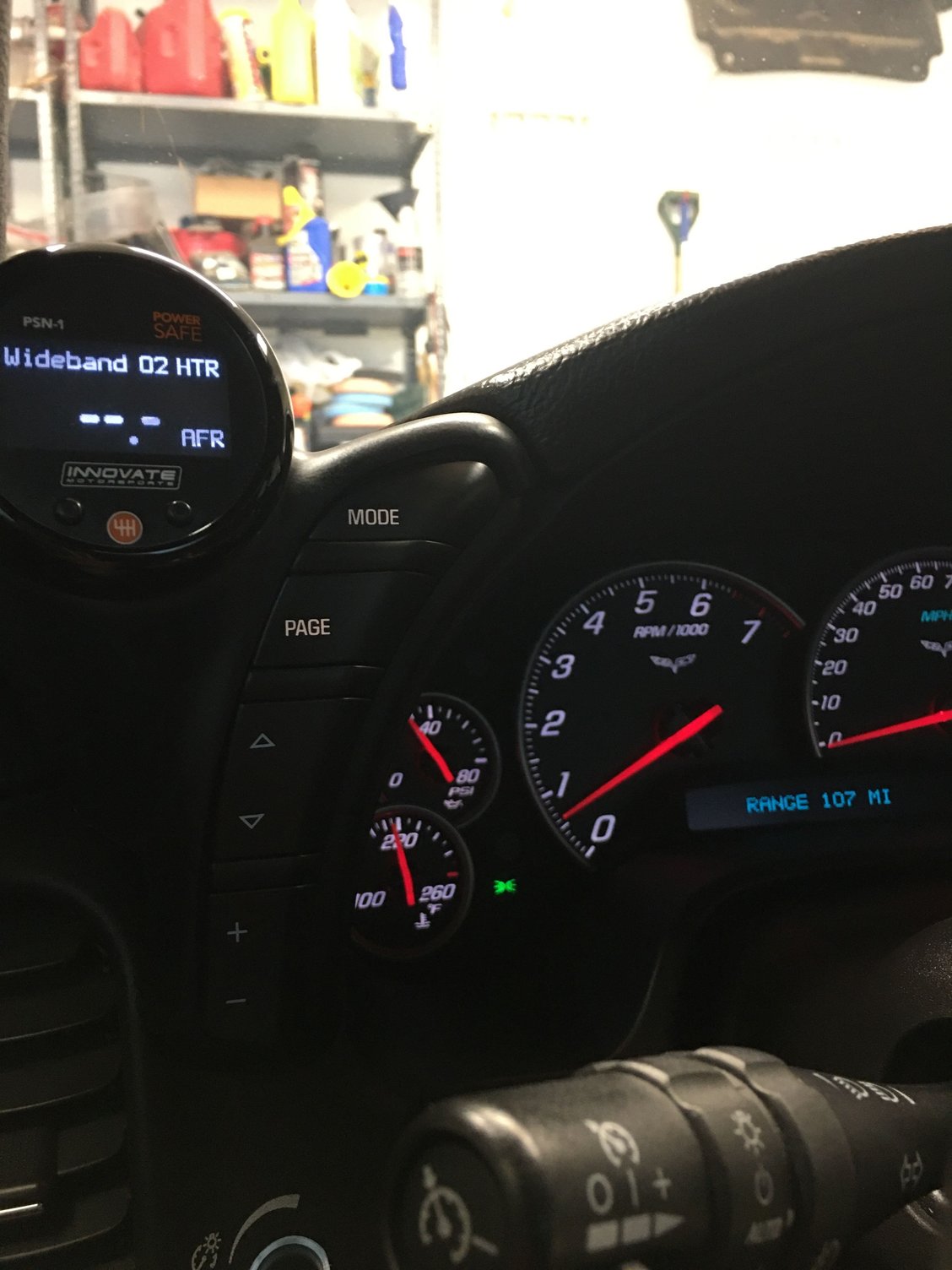

New to the forum and my first thread. Need some assistance! I have a 2010 grand sport. I am having some light issues with the cluster. Only the fuel and reset button lights are out on the right, and the up/down buttons and plus/minus are out on the left.
also, I pulled the cluster out to check the wires. Wiggling the left wires made the up/down arrows light up and go back off. Had them lit up finally until I pushed the cluster back in and they went off. Opposite with the right side. I pulled the cluster out and the trip light went out, put the cluster back in and the trip light started working fine.
im lost here! Help lol
Fuel and reset lights out
Up/down and plus/minus lights out

On my previous GS I found a couple of the wires were pulled out or loose in their respective harness. Make sure they’re all fully snapped in to their respective slot in the harness & see if that fixes your issue.

Same happened to me a while back. The RT one first, then about a month later the LT one. I just replaced them and presumed them to be bad circuit boards. No issues since.
20844868 - LT HUD Controls
20844869 - RT Gage Controls
