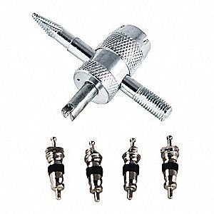

If you have the OEM sensors, they are one solid unit. Remove the valve stem insert and install a new one. Hopefully, that will fix the issue. The stem caps can be easily be replaced with new ones. The cheap metal caps that come on the stems are easily bent, thus hard to remove and install.

I was at the tire shop this morning getting a flat fixed on my Sorento, but while I was there I asked him about replacing the stem insert so that I don't have to replace the whole sensor, and he made it sound like it can be a real pain and sometimes ends up needing to replace the whole thing anyway. Is this something I could do myself in my driveway? Are the stem cores vehicle specific or can I get any stem core?

Do you have a compressor and floor jack/jack stands at home ? If so, you can jack up the wheel with the "bad" valve stem core, support it with the jack stand, then remove the core. You can then go to your local parts store and match up your old one with a new one, replace it and reinflate the tire.
