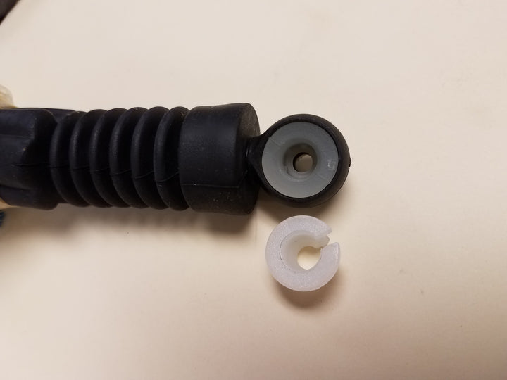

Not on the 2005 A4, and the switch that tells BCM if trans is in park, neutral, or forward gears, is down on the side of the trans at the trans shaft lever that end of cable.
So what you have on both sides of the shift cable is grommets that connects to the shift and trans lever shaft, that can start to wear out.
When the shifter end grommets start to wear out, then shifter assembly in car, is not shifting the trans lever via the other end of the cable down at the trans (and trans position sensor down at the shaft as well) not far enough to switch the position sensor from neutral, into park position, and why BCM sees trans not in park.
So you start with replacing the shifter cable grommets both ends, leave the end of cable adjuster open, put shifter in to drive, click trans lever into the drive position, then snap cable adjuster closed to that length, and so long as trans position sensor is fine at trans shaft, all should be right with the world.
If push came to shove, and before you replace the cable grommets both end, could un-click the cable adjuster to put lever in park, make sure trans lever is in the park postion, lock tthe cable to that lenght, and should at least solve the park problem of car not shutting down (and allow you to check the trans position sensor to make sure it working as well/does not need to be replace/pulled apart to be cleaned), but with the slop in the cable between the two end via worn grommets, going to get funky when you go to shift the trans lever in the car, into other positions.
Also, may be easier to just get car up on lift, move the trans shift lever all the way into the park posistion to move PNP sensor into park that the cable is not pulling it all the way, and if can will now shut down since PNP is telling TCM and BCM that trans is in park, then while car is up, go to town on changing out the cable grommets, and don't forget to readjjust the shifter cable with shifter in park, and trans in park in the end.
On the A6 trans, did way with the external trans position sensor (PNP), and now it has a micro switch up in the shifter, as well as the TCM in the trans, that is telling the BCM when the trans is in part.
Note, on A4 trans, TCM is not in the trans, but rather tucked away behind the ECM in the front passenger fender.
So, either cable grommets are shot and your about to lose trans shifting all together when one of the grommets pops off, the trans range switch (PNP) is bad itself, or when radio what being installed, somehow they screw up the wiring for the trans range switch (PNP), that goes to the TCM So PNP black wire of PNP, goes to ground G402 , and the rest of the wires out off it going directly to TCM..
G402 is #2, and maybe screws up that ground connection when installing say a back up camera switch off the back up lights in the rear of the car.
Or just manhandle the shifter when they where installing radio, to really do the cable grommets in instead.
Hence kind of going with this one as a last thought, and when you get under the car to put the trans shift lever into park fully, puts the PNP into park position fully, and you can now shut the car off, will be going at the grommets to replace them, and reindexing the shifter cable length for drive/drive position between trans lever an shifter positions.

Thank you! My mechanic buddy and myself have dialed the issue in to hopefully being the shift linkage cable either being broken at the transmission connection or stretched to the point it is inoperable. The linkage cable came in yesterday and hopefully in the next few days she will be up and running. We re-built the shifter assembly and made sure all of the sensor switches worked, so I am fairly confident it is at the transmission sensor/connection.
