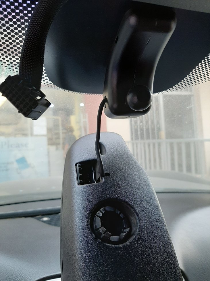

Old May 9, 2025 | 05:20 AM
Fatbloke-Dim's Avatar
Fatbloke-Dim
Joined: Aug 2011
Posts: 92
Likes: 11
From: manchester
Further update !!
Autoglass called to say 'we have your windshield ' ! Fancy that , eh ? Turned out not to have the area for the OnStar blacked-out, but HUD and tint were correct. Might need to get rid of that useless OnStar, if it can be done in a tidy manner.
Old May 9, 2025 | 07:13 AM
kestell123's Avatar
kestell123
Joined: Dec 2018
Posts: 498
Likes: 211
From: Wisconsin
I removed Onstar when I replaced my glass on my vert. That spot on mine does have the the dotted area which I used for my toll road transponder.
