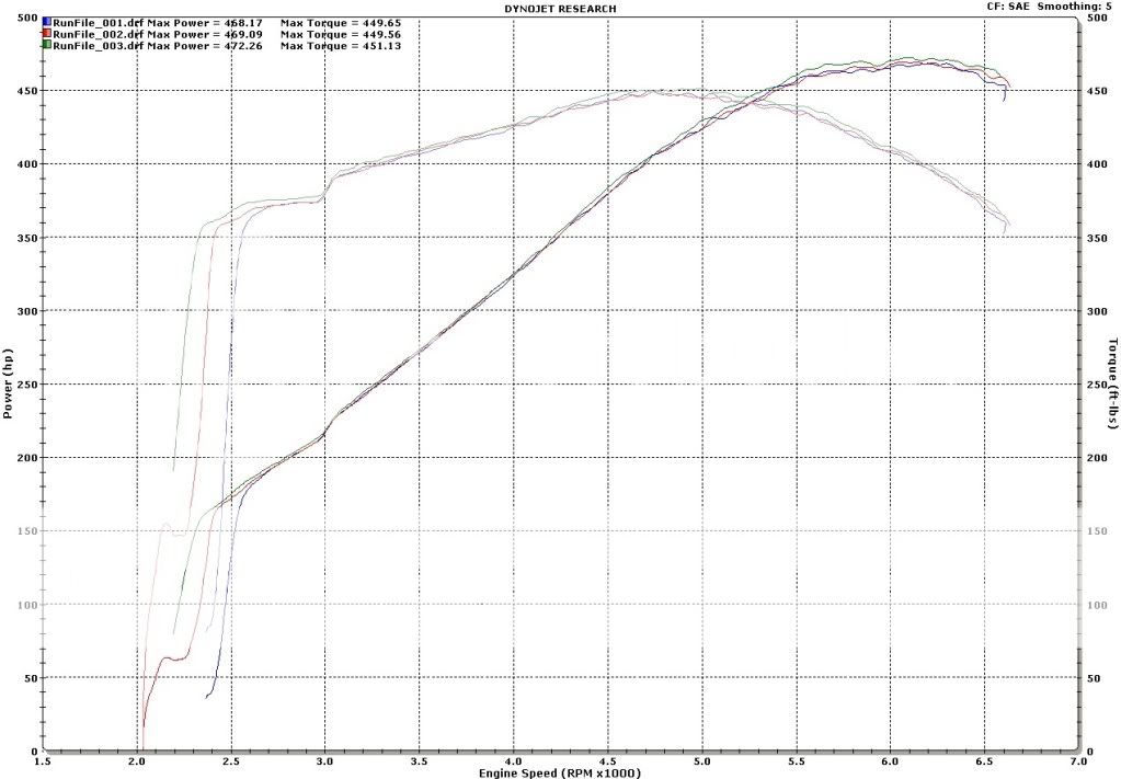

With less than 550 miles on the car I ran my new 2011 Z06 on a local Dynojet 224 and was pleasantly surprised at the dyno numbers, not so much by the 472 RWHP (since this seems to be pretty well on par with expectations) but at the RWTQ....an amazing 451 ft/lbs!
I can only attribute this to the revised exhaust system for the 2011 Z06 where the ZR1 x-pipe is used and the new ZR1 style mufflers......you can see on the on the dyno graph where the exhaust valve opens at 3K RPM and the affect that it has on the very nice smooth torque curve.
Dyno conditions were 58°F, Barometer 29.64", 24% humidity and the SAE correction factor was 0.97. The uncorrected numbers were an astounding 488RWHP/466RWTQ! And before you call out "freak or bogus dyno", it is not! I have had one of my other vehicles dynoed locally and on this dyno and the numbers were within 1.2% of each other (well within acceptable standard error limits) and the truth be told, the dyno that I ran the Z06 on was actually the one that registered 1.2% lower!

interesting. i've been running this combo on my 07Z for some time now. Now i just need to dyno it. I'm sure there's more fine tuning in the ECU on the newer cars to help with more hp. maybe a data logger guru will chime in.

You would think the changes made a difference. If thats the case, Chevy should have upped the specs on the engine as a selling point.

Good point! The LS7 505HP SAE rating is through the H-pipe and non-ZR1 mufflers! What a shame....false advertising!

My car also recorded some big torque numbers on a Dynojet 224 with the ZR1 exhaust, but I also have a MF103 on my car. I was able to boost the torque numbers a bit by running a 50/50 mix of pump/109 fuel, where I recorded a max of 484/457. My fuel mix, in conjunction with the MF103, helped lean the WOT AFR in the lower RPM's...bumping both my low RPM torque numbers , which also resulted in higher RPM HP numbers.
But, after all's said and done, it's just a number. For me, the true test for the claimed HP/TQ numbers came from the performance of the car on track

Yes, and all the fastest cars are the older cars as well (pre x-pipe). The dyno numbers posted here are interesting but without back to back run both with and without the x-pipe, it doesn't really prove a whole lot. I wouldn't be against popping one on my car though

maybe the x pipe flows a little better but you need to dyno both h and x on the same day , same dyno to really know the difference.
I have to agree, however, it seems that if the cars ('06 & '07's) dyno the same as newer ones and the relative weight of the cars are the same then you would expect 1/4 mile times to be similar, that's all I am trying to point out....as to why there are no newer cars running as fast as these times all I can speculate is that people are either not running them at the track as often because they already know what it "should run" based on people who have already raced theirs or....???
I agree!
