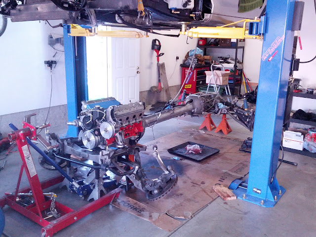

Look at Funkybirds blown motor. Dropped a valve, windowed the block/pan/etc. Everything was trashed.
Remember to take the console off and disconnect the shift ****/boot so it will drop out. You will have to disconnect some brake lines to drop the cradle. Rear driver side and I forget the other but one up front. I left the abs module hanging in the car, same with a/c compressor since I didn't want to recharge it.

I've dropped my motor out on a 2 post. Pretty east. Disconnect wiring, fluid lines/etc, exhaust, tunnel plate, upper suspension to body, then 4 bolts from and 4 rear and everything drops out.
