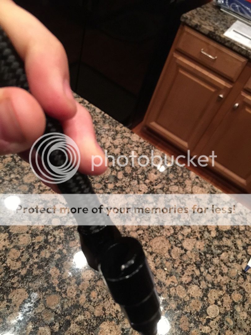

So, I'm not going to throw any vendors under the bus just yet, but I have some issues with the shipment of parts that showed up today. Does anyone have any experience with the Torrent Fuel Line kits for Fast rails? Here is what I received today at the end that is supposed to quick disconnect to the factory fuel supply line...
When screwed together it looks like this...
Does anyone know where I can get the correct fitting or line for Saturday delivery this weekend? Need this replacement line ASAP and am also waiting on feedback from the vendor. To give them the benefit at this point I sent the emails this afternoon and they may not have had a chance to response, but I NEED this ASAP. Thanks for anyone's help and more updates to come when we start doing more installation tomorrow!

After some research, what I received is the LS1/LS6 lines... Need any help I can get to get the correct Torrent Black/Black line kit by Saturday. Waiting to discuss with the vendor but if I need additional help, does anyone know who has these in stock?

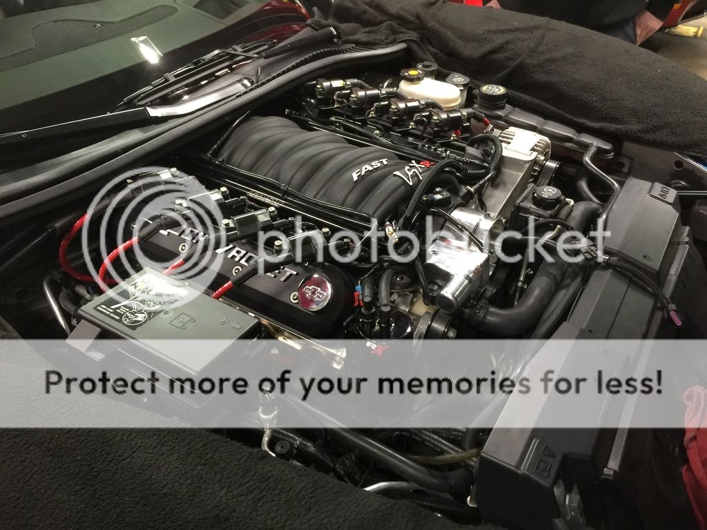

In the course of continued learning, here is what I found out... The connection I received (shown in my post above) is shown in pictures for the LS1/LS6 unit. Pictures of the LS7 unit show the quick disconnect, like stock. I learned today that either will fit the car, but the one I received does require you to get in there and tighten it with a wrench. That proved a little more difficult, but everything is on and I'm waiting on a few last minute things and putting the airbox on before the startup tomorrow!

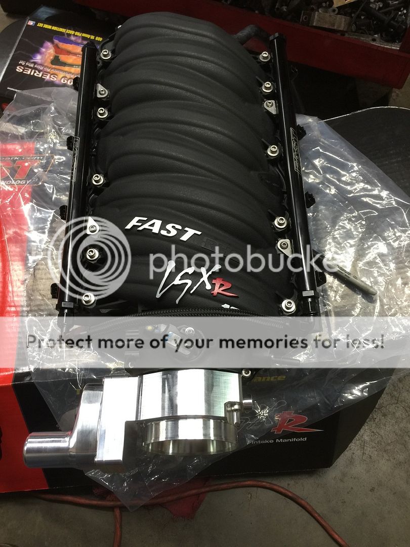

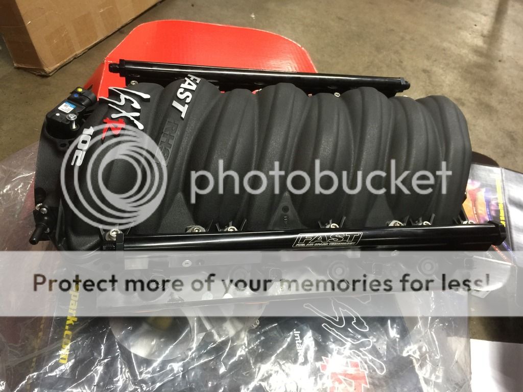

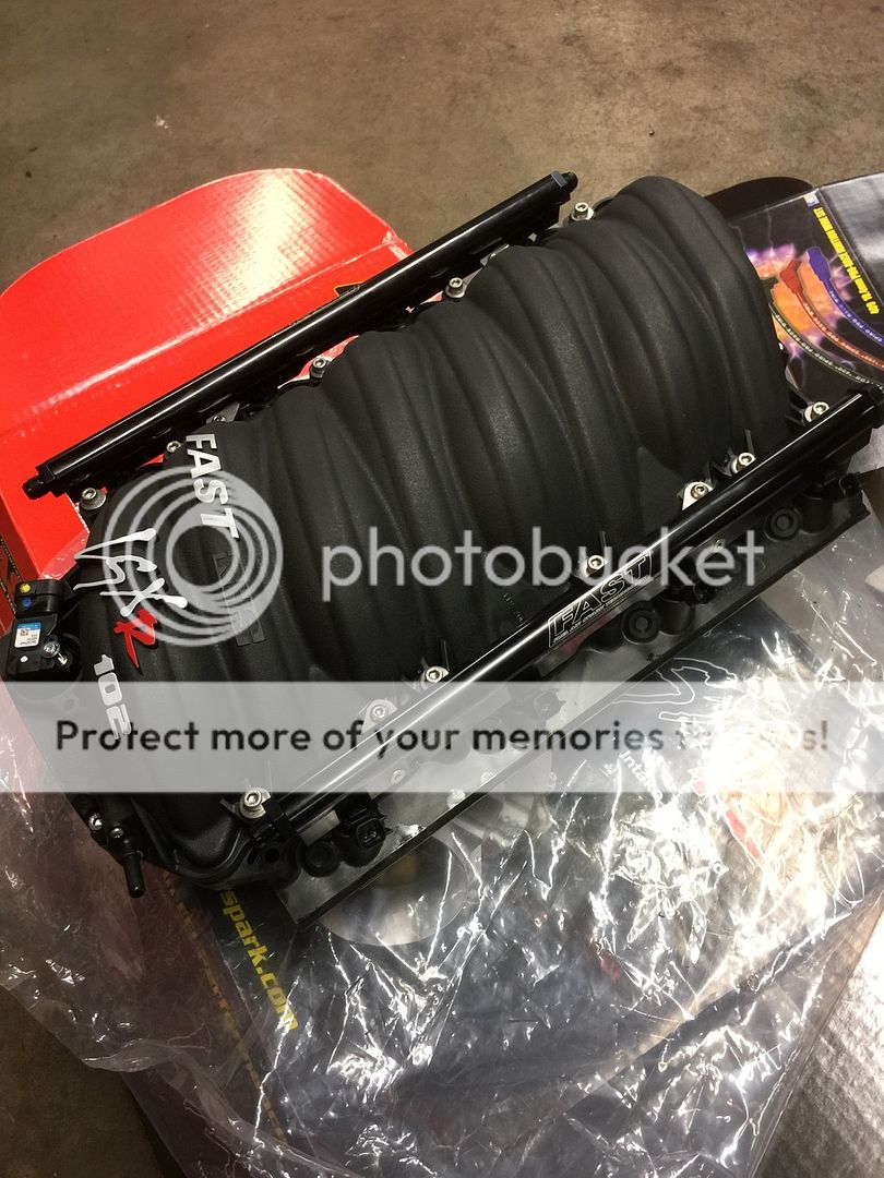

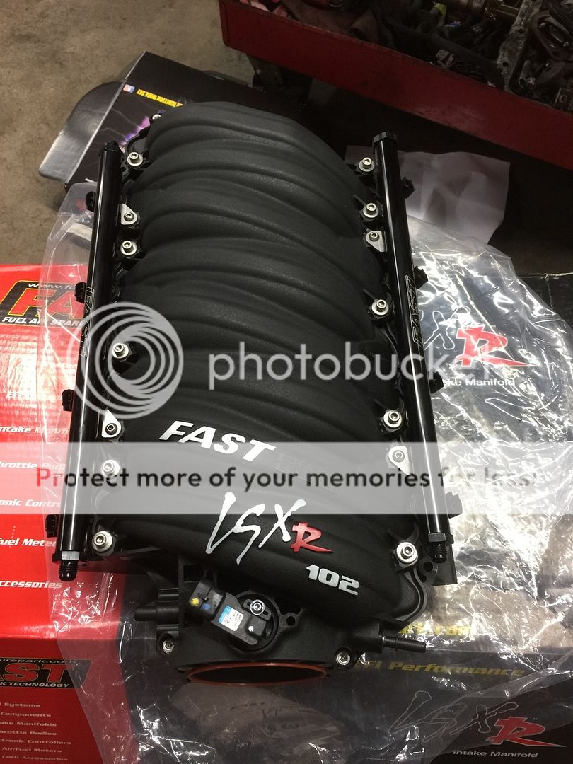

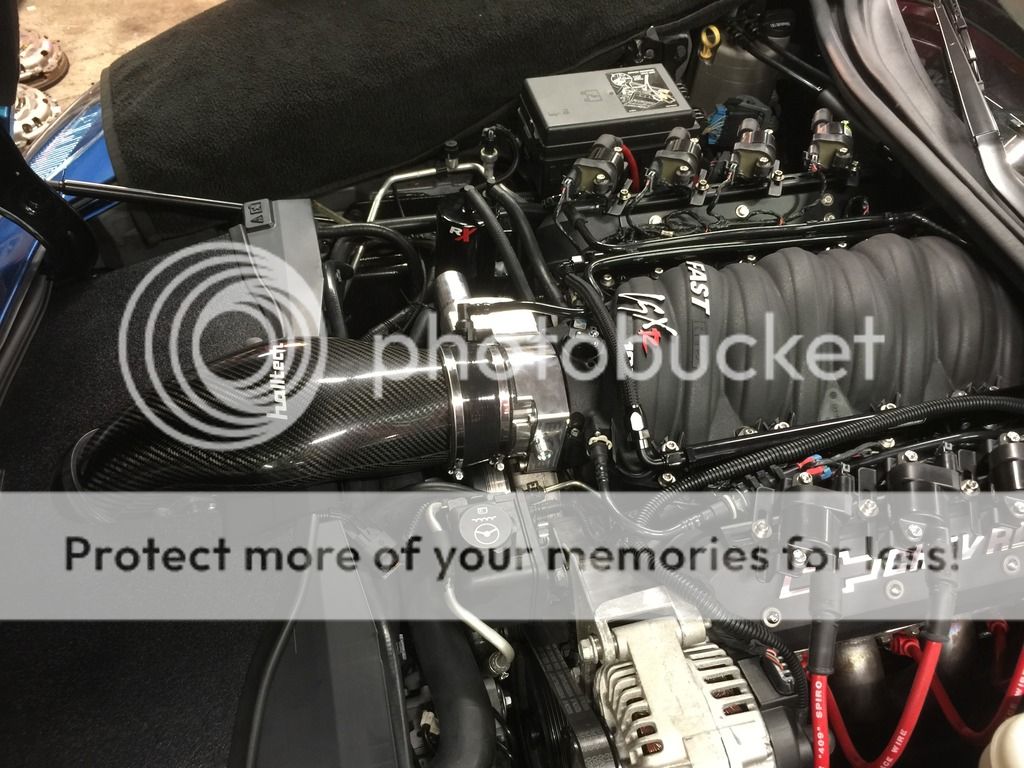

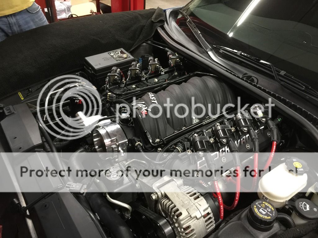

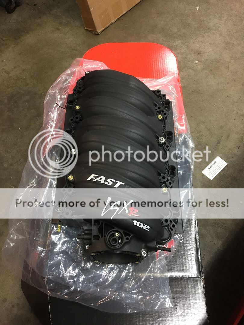

First came the installation of the newly available BLACK LS7 Fast 102. Finish is very nice and it was ported to clean up the internal molding lines and to closely match my MAST 305 heads...
I then installed the factory ZR1 injectors to give me just a little more headroom for my N/A setup (shorty style like the stock LS7 injectors) and some black Fast rails...
Originally I ordered the Black NW 102 throttle body, but it came in as billet, which grew to like more with some contrast to the blacked out theme. I'll likely add in a billet/polished Billet-Tech alternator very soon and polish the factory bracket to set this look off...
I still have some of the wires just hanging there, so it looks a little funny still. I had some custom wires made by Taylor and had them made a hair too long and don't like the 135 degree boot on the spark plug as it touches the header bolts. I'll be having those remade soon to fix this. Overall, I'm getting very close to the finished product, and am pretty happy so far!

I was going to use ZR1 injectors until I did some research. In fact I had bought a set which I returned.
The ZR1 injectors have a spray pattern and angle of spray designed for the ZR1's boosted intake manifold, which is very different from a NA manifold due to very different port configurations. I was also told that the fuel spray would impinge on the sidewalls of a NA manifold, causing fuel droplets to form. The tuner said he could "tune this out", although it was not ideal. I confirmed this with an fuel injection specialty house.
After dropping +/- $10K into the top end of my motor I made the decision I didn't want a 'bandaid' and I went with a brand new set of matched LS2 Bosch #60 injectors.

I have the same valve covers. How did you plumb the valve cover vents? I'm still deliberating how to spruce mine up.
As far as fuel lines, Holley makes a couple kits that works with their fuel rails. They also have a quick connect fitting. I'll be installed them this weekend and can report back on how well they work, or don't work...

I'll take some more detailed pictures next time I'm up at the shop (next weekend), but I put 90 degree elbows off of the valve covers and then cut the connectors off the plastic lines and put them right into the elbow. It actually looks pretty good. I also rerouted the fuel vapor solenoid over to the driver side valve cover and extended the wire hardness to fit it there instead of running the ugly plastic tubing all over the nice new throttle body.

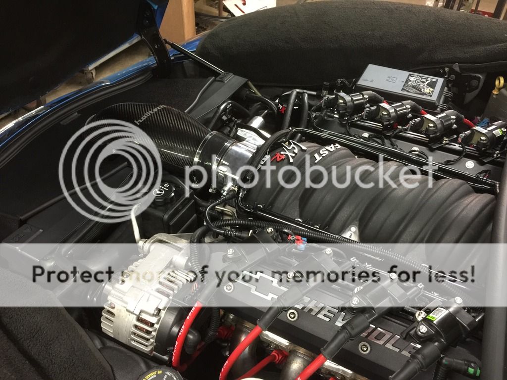

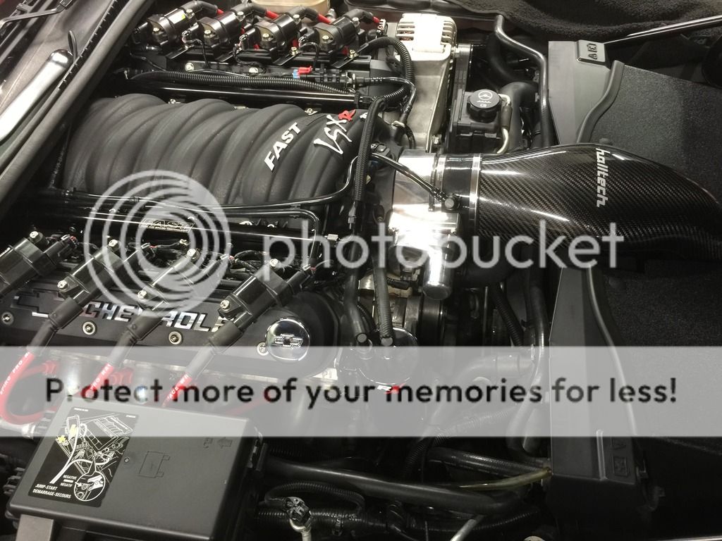

Update, started the car this afternoon. Start up tune was VERY close, but still lean. Did some logging and definitely a huge increase in throttle response. The clutch seemed very smooth but you could make it chatter some if you tried so that will take some getting use to.

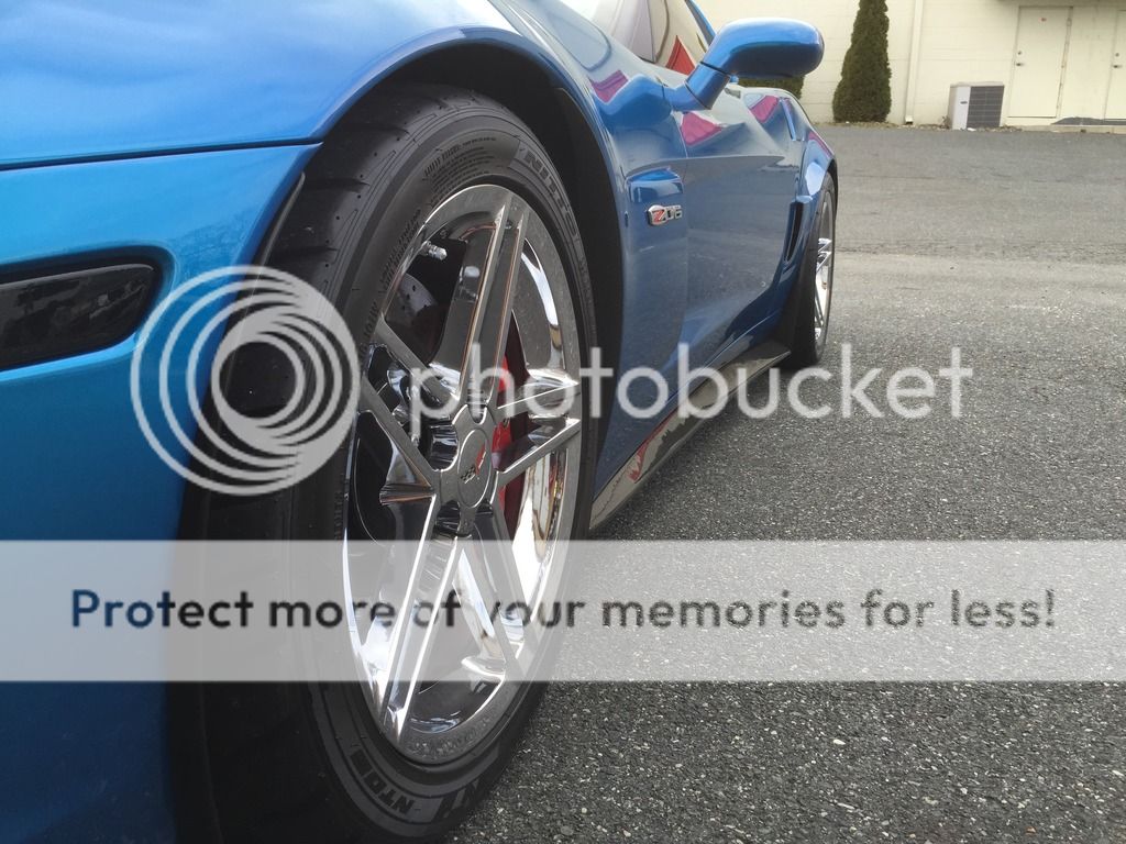

Also got my C7 Carbon extended side skirts on. The fitment wasn't great, but after egging out some holes and drilling new ones in some places, some ingenuity and patience, they went on and look outstanding. Keep in mine I used 5mm spacers at all 4 corners and some ET lug nuts which DRASTICALLY changes the look in person. The wheels are much more flush.
