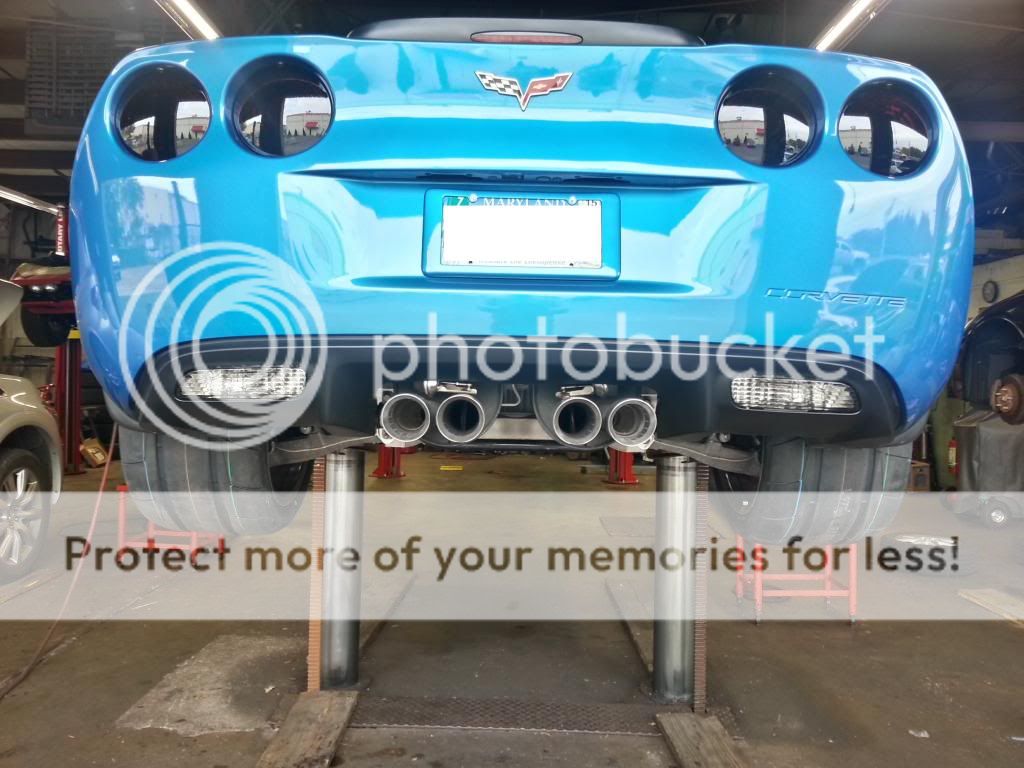

I went back and forth on Corsa, Bullets, all over the place... Until I met a guy with a 2011 Carbon Edition Z06 at a car show and heard the difference in the ZR1/11+ Z06 exhaust. What a beefy sound from the non-perforated pipes... So I began looking and picked up a 1900 mile setup from a new ZR1 at Carlise for $150!!!! What a steal and it made a huge difference! The car came with a Mild 2 Wild so I was good there...

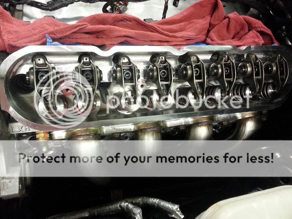

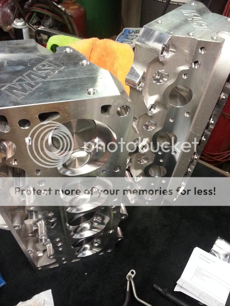

As I approached winter, I decided that I was mechanically-inclined enough begin the tear-down in my garage. The plan was to do headers, fairly aggressive cam, C5R timing chain, intake, RX catch can and all the supporting new gaskets and seals. Ended up going with MAST 305 heads, Race Proven Motorsports B3 cam, Halltech CF112 intake and American Racing 2" primary headers w/ cats... In the process, I had the stock LS7 manifold ported out for the bigger heads and my factory throttle body ported as well.

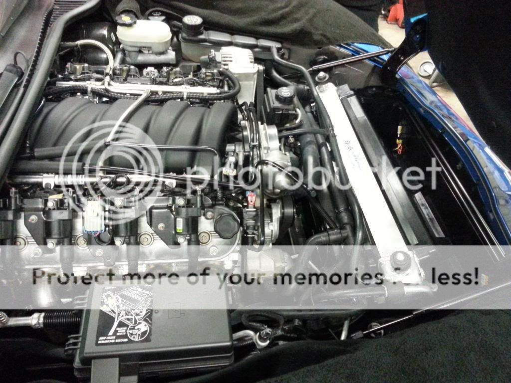

Along with the build parts I planned for, I ended up with a DeWitt's radiator and an MGW shifter. Both have made great compliments to the other mods.
As spring 2014 came up, Rob Metzger at Gallant's Automotive helped me get the car put back together and Mike Bruce from B&B Corvettes did some road tuning with us remotely via HP Tuners. After the start up tune was loaded, here was the very first start!
And when it settled in after warming up
Then started the remote road tuning. Mike worked magic and worked with rob to get it in very drivable condition. Drove it around every once in a while for a month until Mike flew in and tuned it on a nearby dynapack that we rented. The car made 639hp and 538tq... As we all know that dynapacks require the wheels to be removed and calculate things differently, I'd estimate it's a 600-610hp car accounting for some inflation. The car sounded beastly on the dyno

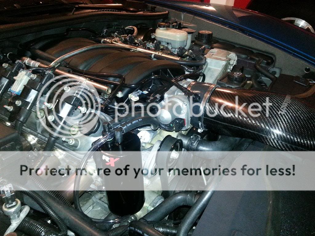

Now that the tune is done and the car has been running great for almost a year, it seemed like a good time to finish up the bolt-ons... Got a FAST 102, FAST billet rails, ZR1 injectors, and Nick Williams throttle body. To hold the power and help throttle response, I also picked up a Mantic 9000 thanks to Geoff (Mantic Rep) and Rick from RKT.

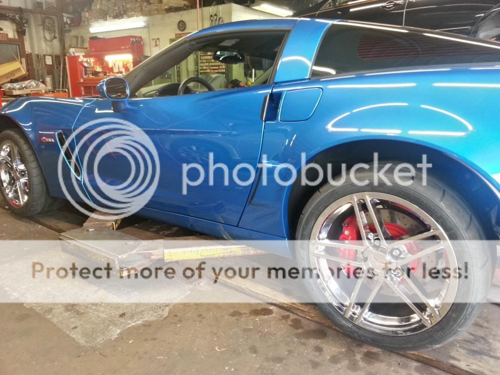

Some pictures of the current exterior state from last fall... Should have my Carbon Fiber side skirts and front ZR1 splitter on soon!

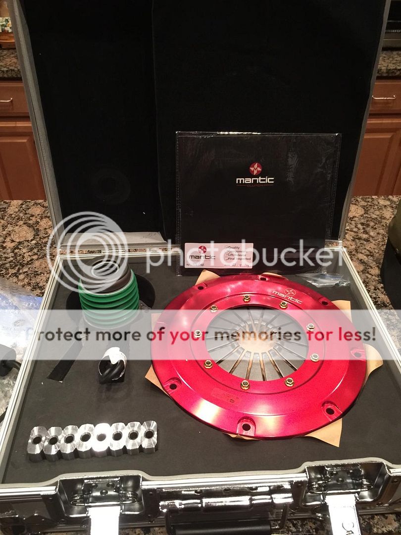

Mantic clutches come in aluminum cases? That's taking packaging to a new level....

Z06_1
CF Senior Member
Member Since: Aug 2014
Posts: 323
Thanks: 0
Thanked 0 Times in 0 Posts
I was thinking the same thing.. Kinda of like a "if you have to ask how much it is you can't afford it.." level..

Those Aussies know how to impress. Just pack the clutch in an alum briefcase!
Does your Mantic clutch have the outer portions of the pressure plate and discs machined to reduce the moment of inertia?
Did you use the organic or ceramic discs?

Beautiful car! Those Aussies know how to impress. Just pack the clutch in an alum briefcase! Does your Mantic clutch have the outer portions of the pressure plate and discs machined to reduce the moment of inertia? Did you use the organic or ceramic discs?
I think it has machines plates but I can take pics when I open it next time I'm at the shop or when it goes in next weekend. It's setup with cerametallic discs.

Regarding your decision for exhaust: what was needed to install the '11+ exhaust system - was it a bolt-on or some fabrication needed? Are the '11+ exhausts between the ZR1/Z06 and Z06 carbon all the same for the exhaust sounds difference? And did you replace mufflers only, cat back or manifolds back?

The exhaust was a direct fit, but I also put the X-pipe from the ZR1/11+ Z06 on at the same time. it bolted right up to the stock manifolds. After that, I swapped out the headers for the ARH 2" primary setup and that X-pipe bolted right up to the slip-on connection of the axle back from the ZR1/11+ Z06. I think they are all very similar, although I have seen some with perforated holes inside the the inner and outter tips, and some only perforated on one or the other. The important part is that the inner pipes are solid when you look down in them with a flashlight, vs. completely perforated like the 08 Z06 is stock. That is what makes it louder and better flowing.
Hope this helps!

Headed up to get the car out this weekend... Starting the Mantic 9000 clutch install with remote bleeder and fitting the new Proform valve covers. I'll need to measure for some customer Taylor wires to fit the relocation bracket. Pics to come!

What heads do you have and did you have to clearance the alternator fins or bracket? The MAST heads seem to be slightly taller so the normal wires used on a car with headers were JUST too short so I had to get an inch or so longer. Hence my concern about clearances with the alternator for the valve covers.
