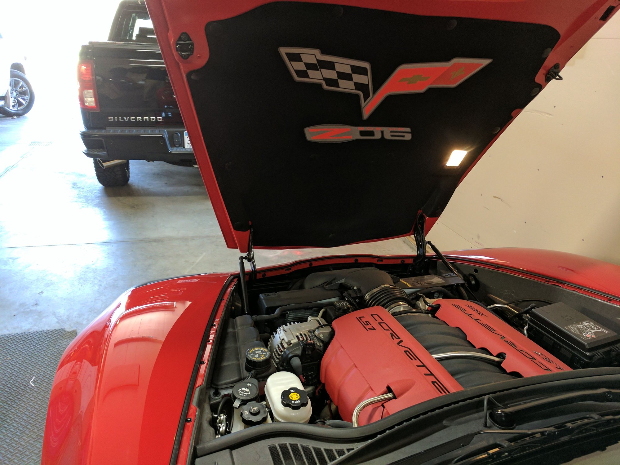

Sounds like a replacement is the confirmed answer. Was hoping this money could go towards the reworked heads, headers, cam, intake, etc., but best to be safe especially if the wife will drive it also. Here are a few pics...
My wife took this while I was driving, so my hand was on the wheel

If you are just driving in town, I would drive on the tires for a few miles an see how they feel. Not sure I would go out of town on a trip, but around town, I would be ok with that. But I would sure be saving some money for new tires. Great looking car btw.
LMB-Z is offline   Reply With Quote

PS) Your wife wants you to get your new Z06 out of the living room...
Quote:
Originally Posted by SilveradoSand View Post
MTPZ06 is offline   Reply With Quote

OP, enjoy your new Z06. It looks like it came right off the showroom floor.
