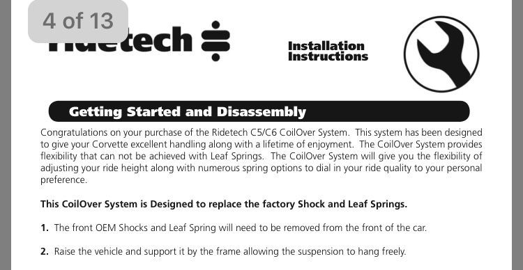

Quote:
Originally Posted by Jjagg0125 View Post
I m really starting to think this is the case.
i just looked at the instructions and they state they need to be removed
TPSMak is offline   Reply With Quote
Old 10-11-2017, 08:43 PM   #22
Jjagg0125
CF Senior Member
Member Since: Jul 2016
Posts: 188
Thanks: 0
Thanked 3 Times in 3 Posts
Quote:
Awesome thank you for the info! I am going to pull them out ASAP.
