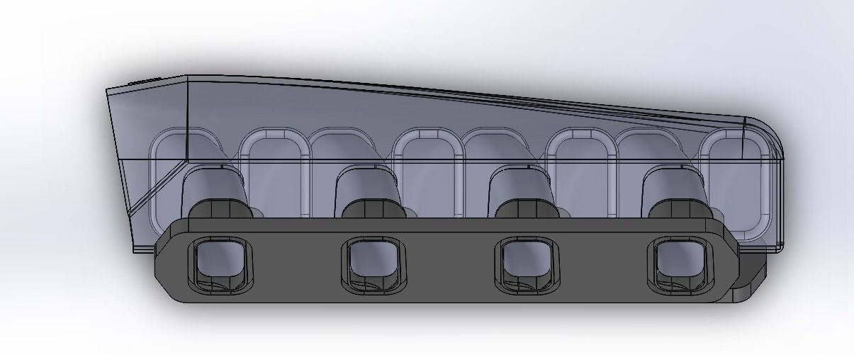

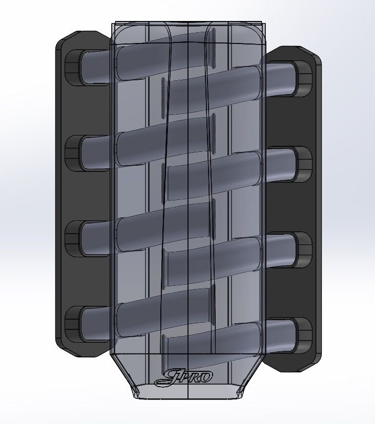

Old 06-21-2018, 03:16 PM
  #35
0G1Pro
Former Vendor
Member Since: Jun 2017
Location: Katy TX
Posts: 478
Thanks: 0
Thanked 19 Times in 14 Posts
Our Billet LTx
We are doing a longer runner ls7 adaptation for Jeremy and HPR's big cube ls7 builds
G1Pro is offline
Old 06-21-2018, 06:00 PM
  #36
Navy Blue 210
CF Senior Member
Member Since: Mar 2007
Location: Coast of San Mateo CA
Posts: 326
Thanked 41 Times in 38 Posts
Wow that looks Awesome!
What is the Peak RPM designed for?
Navy Blue 210 is offline
Old 06-21-2018, 06:05 PM
  #37
0G1Pro
Former Vendor
Location: Katy TX
Posts: 478
Thanks: 0
Mani in picture as stated is ltx
I'm working with Erick @ HPR to bring exactly what they need for the big cube builds they do
G1Pro is offline
The Following User Says Thank You to G1Pro For This Useful Post:
Silver Bullet C6 (06-21-2018)
Old 06-21-2018, 06:26 PM
  #38
MOTOWN Z
CF Senior Member
MOTOWN Z's Avatar
Member Since: Mar 2014
Location: Atlanta Georgia
Posts: 156
Thanked 23 Times in 20 Posts
OOOOOOHHHHHH Me likey!!!!!!!!!!!!!!!!! that intake is Beautiful!
MOTOWN Z is offline
Old 06-23-2018, 04:23 AM
  #39
MTPZ06
CF Senior Member
Support Corvetteforum!
MTPZ06's Avatar
Member Since: Dec 2008
Location: Honolulu HI
Posts: 12,787
Thanked 1,153 Times in 1,023 Posts
That thing looks sick! Is it set up for a 102 or a 108 TB?
MTPZ06 is offline
Old 06-25-2018, 07:43 AM
  #40
441LSXTT
CF Senior Member
Posts: 538
Thanked 39 Times in 33 Posts
Here is the LS7 design. It has 7.5” length runners fully tapered and Full radius air horn runners.
441LSXTT is offline
