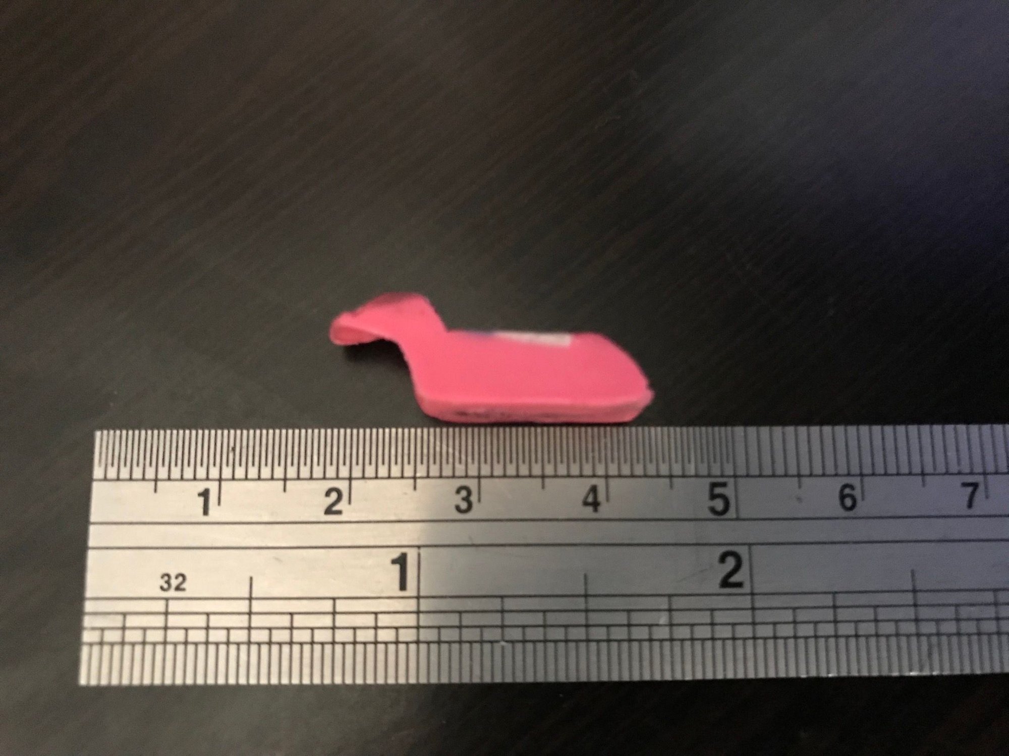

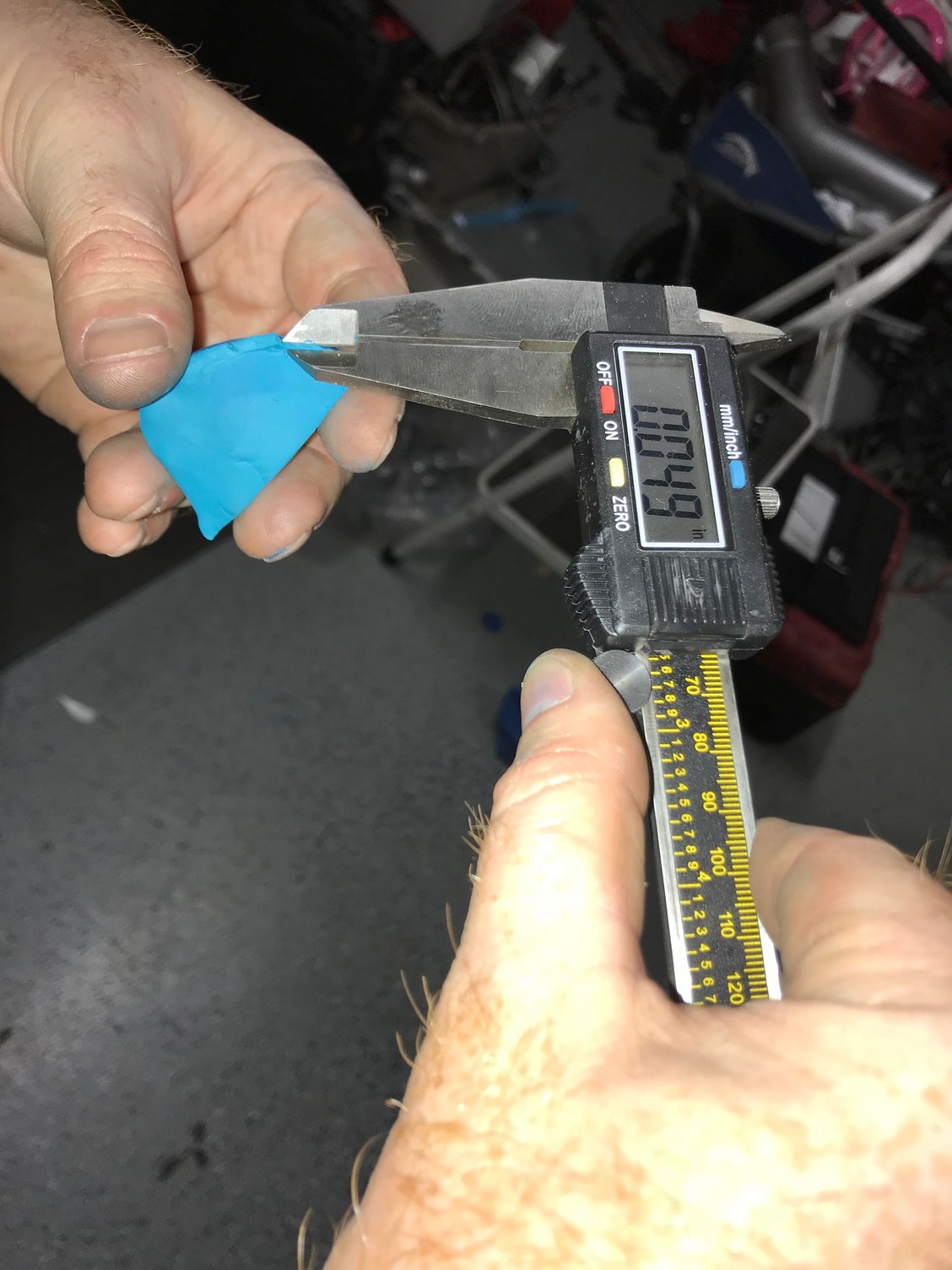

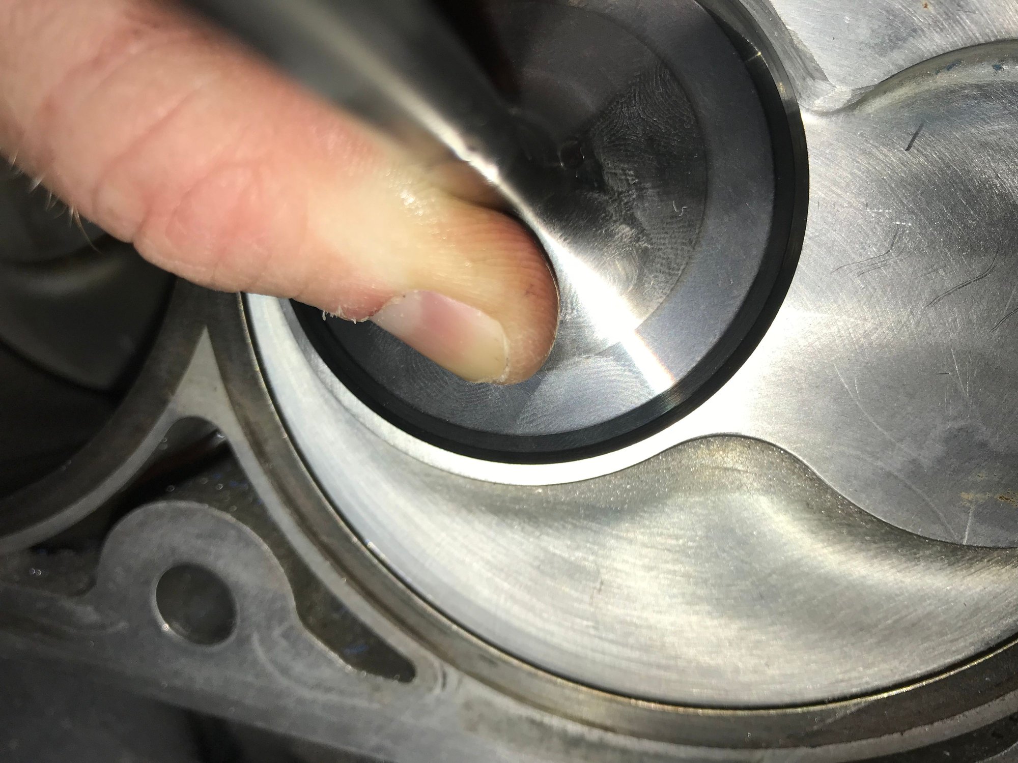

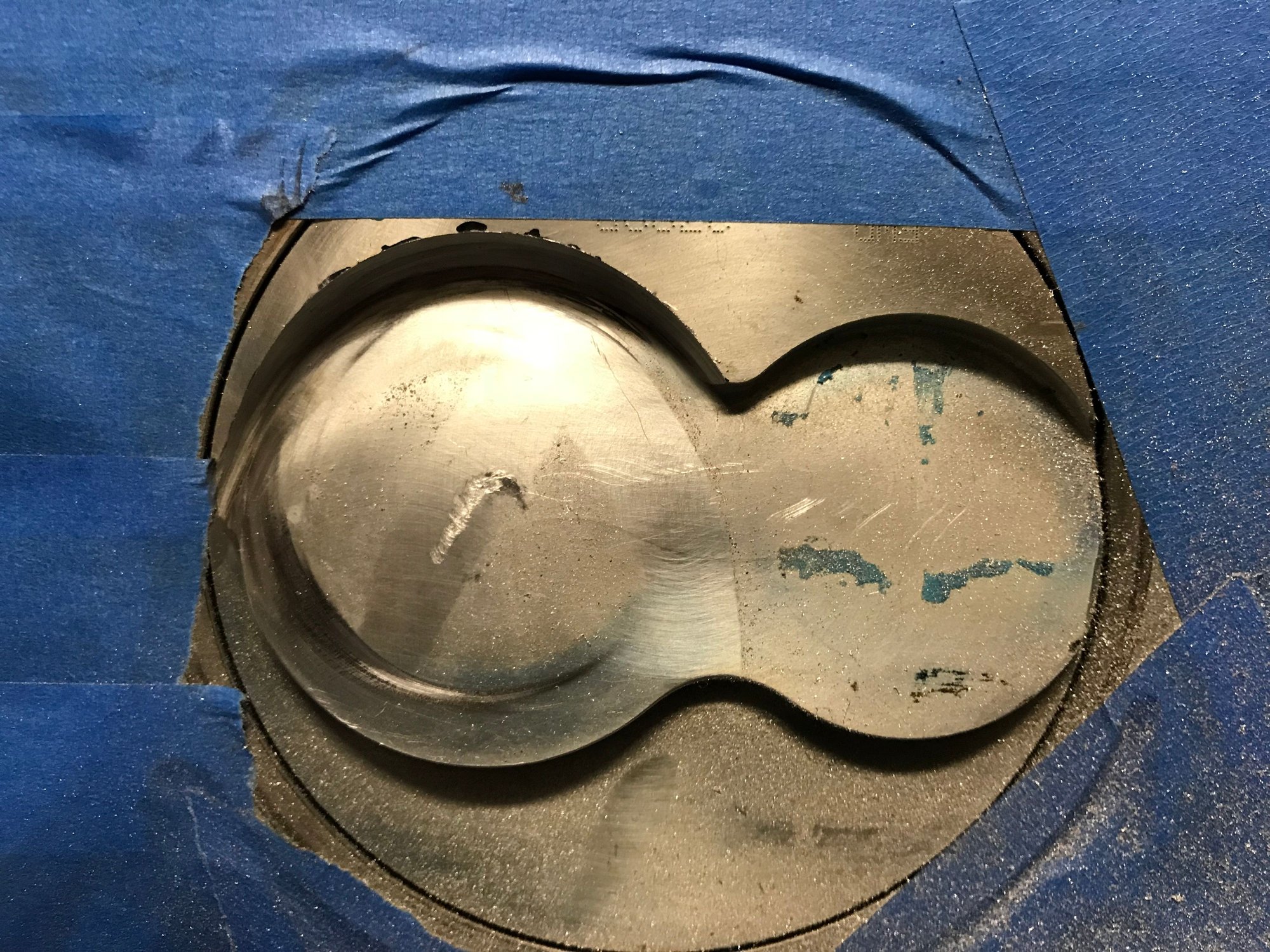

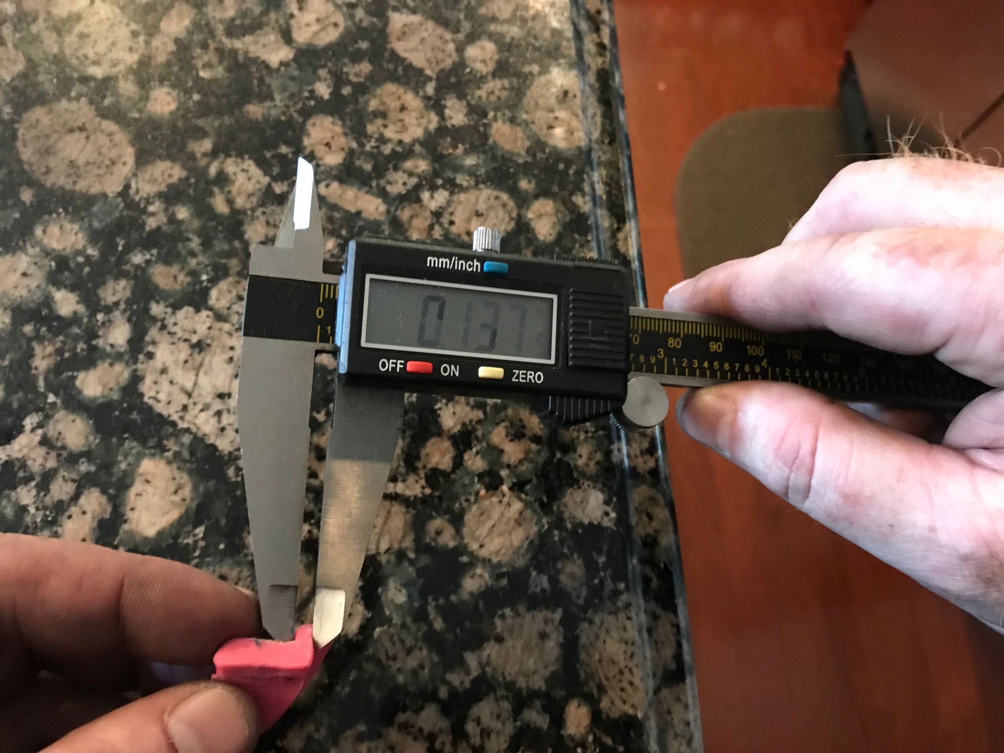

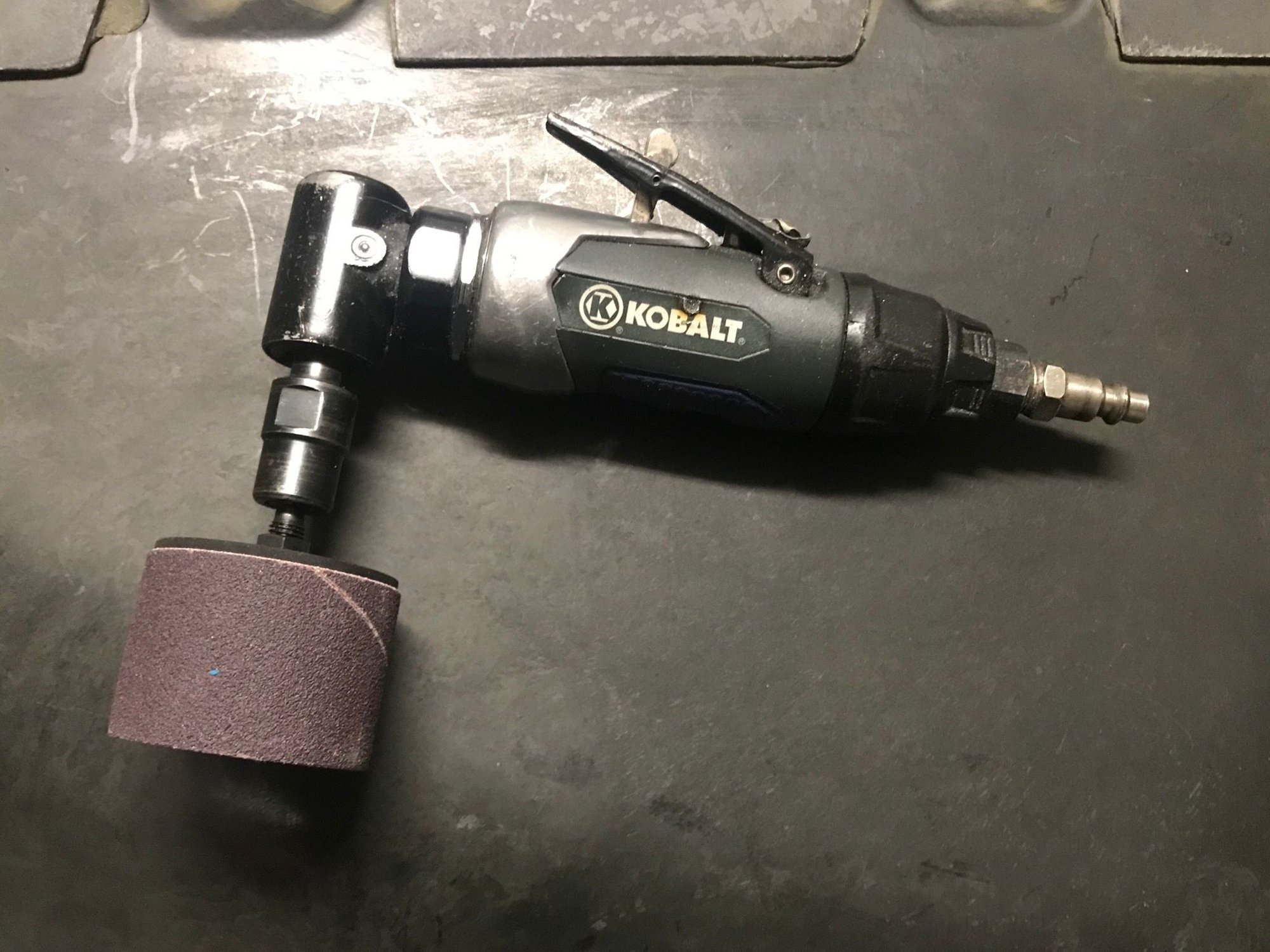

Piston to valve radial clearance was too low, .048”. PTV axial was around .240”. So I did not need to flycut necessarily, but I needed more radial. So I decided to sand roll the intake valve reliefs with a 2” sanding drum on my die grinder.
Final radial clearance came out to .137”, so plenty of room for things to move at high rpm.
