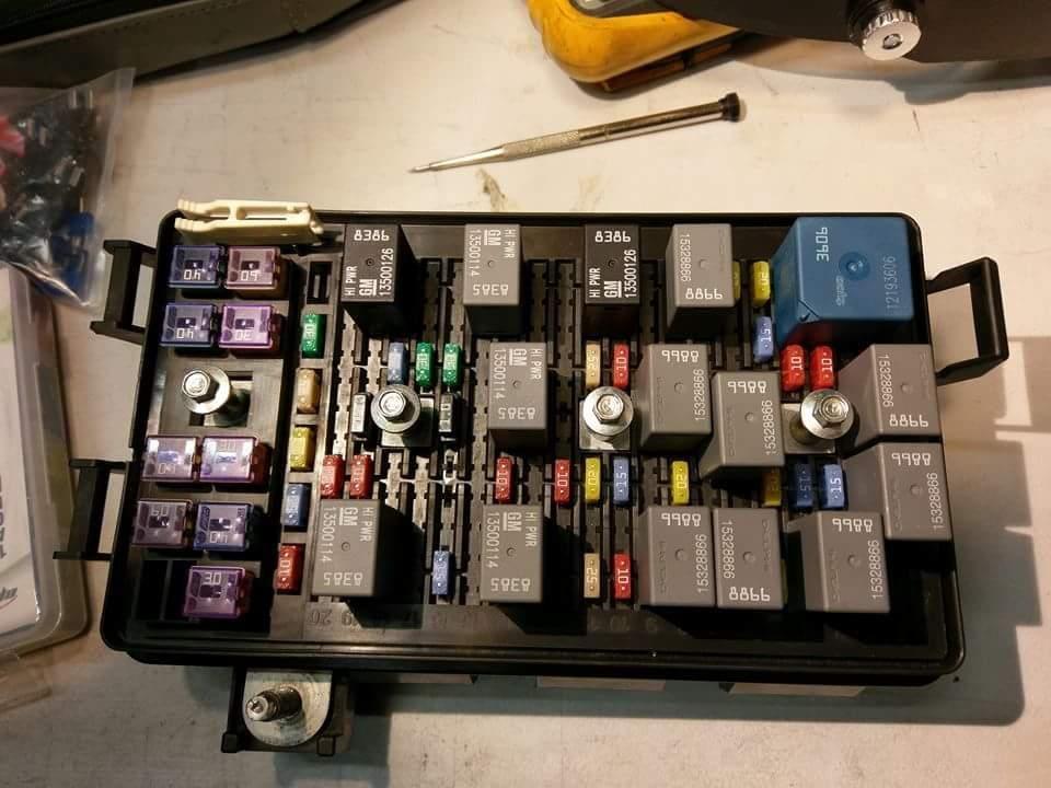

I thought the same thing but on my car there is a very defined difference in how it runs and I have been running the 30 amp fuse for quite a while now and have not seen any bad effects. It changes the noise the injectors makes and it also changes the tune. Have not got to the bottom of why the car runs a lot better but still working on trying to figure it out. Also a side note if you have a Bose stereo the J fuse in the engine compartment current limits badly the Bose amplifier I have changed that fuse up as well and it massively changes how well the Bose stereo works. All of this may be heat related as the fuse box sits right over the exhaust header and gets really hot and if you look at little fuse data charts as the temp rises the fuses do not operate any where near there rating.

I had my fuse box apart and it is very cheaply manufactured. I'm guessing your problem may be from poor conduction... weak or corroded terminals.

Always a risk when you increase a 20 amp rated ckt with a 30 amp fuse. Wiring has to be able to handle the addtnl current if something goes wrong.
