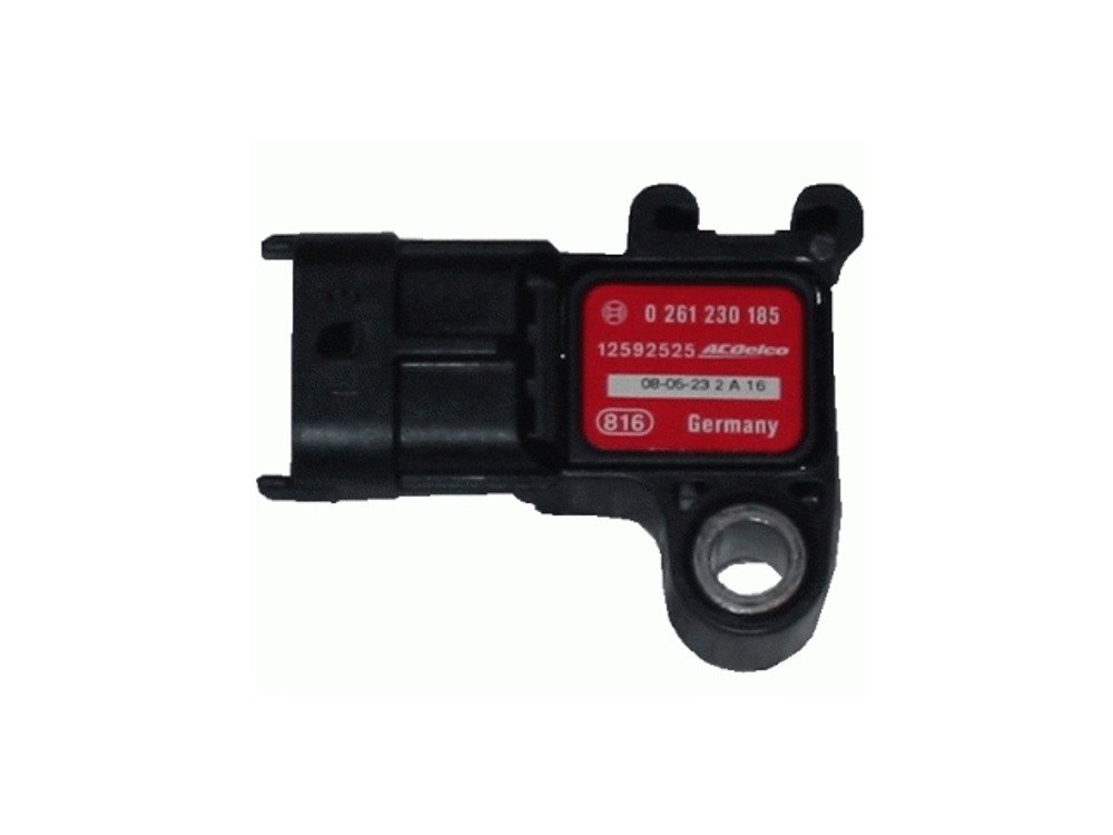

Make sure you have this MAP sensor for your LS9 engine ... If not, it won't run
ACDelco 12592525
ACDelco 12592525
