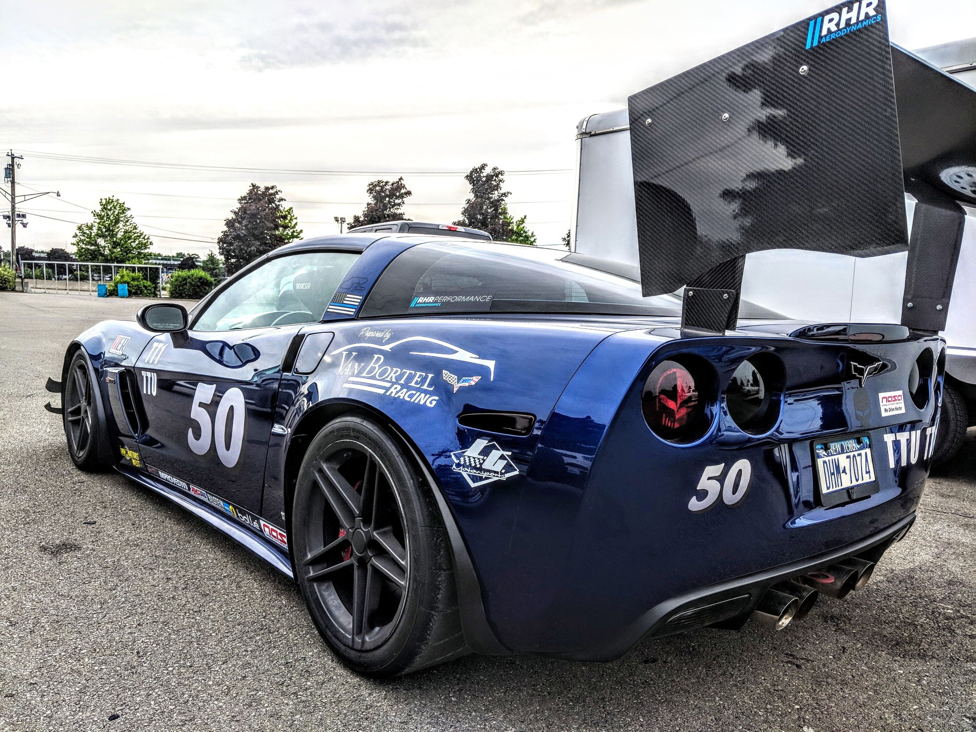

Correct, that is me in my car that I built and race. If you have the time, search my profile for previous posts going back as far as you like and you will find as much information as you feel like reading regarding putting our cars on a race track.
Originally Posted by 1Paladin1
- The 4 items for the modification of the dry sump are equally applicable to the 2009 onward models or just to 2006-2008? I am guessing only item 1 is not applicable from 2009 onwards or I didnt understand correctly?
Correct.
- Wheels you said 18 all around..what offset are you using and what is the optimum track width/profile tyres for back/front?
Here is what I run:
18 x 11 Finspeed F10 (offset +38) ◊ 2 w/ knurled bead
18 x 13 Finspeed F10 (offset +56) ◊ 2 w/ knurled bead
These are new and will be on Hoosier R7 315/30ZR18 (front) and Hoosier R7 345/35/18 (rear)
and
18 x 11 Signature SV502 18x11 (offset +38) x 2 w/ knurled bead
18 x 12.5 Signature SV502 (offset +50) x 2 w/ knurled bead
These are on Hoosier R7 295/30ZR18 (front) and335/30ZR18 (rear)
and
OEM Speedline wheels with NT01s in OEM sizes. Which are Front: 275/35-18 and Rear: 325/30-19
All of these work great and look good doing so.
Pics as proof of this claim:
Signature on Hoosiers:
OEM Speedlines on NT01:
On the track at speed kicking some Viper ***:

What a beauty your car is!!! Love the inverted aero!! Seems its the latest trend in generation of downforce. Do you also use LG GT2 suspension? what are your spring rates? I see the FL wheel slightly elevated?
Can you actually do corner balancing in the car by relocating items to bring the CoG a bit lower (its already low) and a bit closer to the centre of the car?
I'm on LG G2s. They are non-adjustable but use a superior Bilstein inverted shock. I don't need the adjustability as LG already valves them for our car/suspension/use. My springs are Hyperco, 700lb front and 650lb rear. The front left was slightly elevated in that pic on the track because I was taking a corner at 100mph+ and pulling probably close to 2gs, so the weight transfers to the right. If I wasn't on coilovers with stiff springs and huge sways I would be on two wheels.
Yes you can corner balance by this method. Last year I ran 100lb of lead ballast bolted down to the passenger footwell to meet weight requirements for my racing class and to help with corner balancing. I have pics of this I can share if you want. It is simple and easy. But it isn't absolutely necessary and the car can be corner balanced easily without the ballast as the weight distribution is already very good from the factory.
