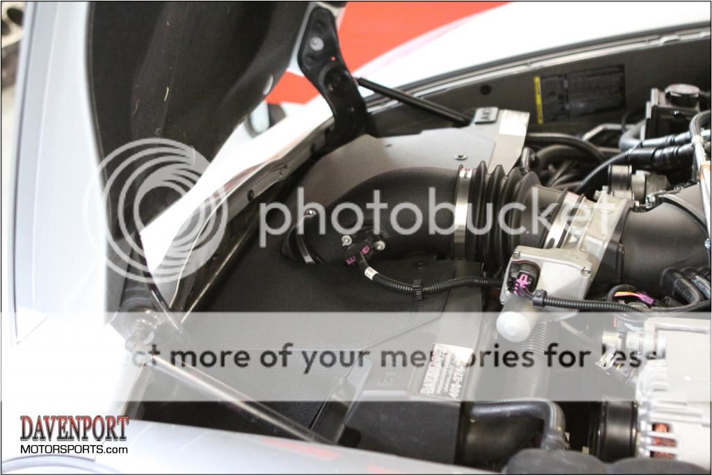

Originally Posted by CI GS
How much fabbing/tweaking did you have to do to get the LPE ZR1 intake to work?
Davenport Motorsports has run the LPE ZR1 intake on a HB build. I was looking at doing the same to my car, but decided against it when I found out the Lingenfelter shroud was proving to be an airflow restriction at higher power levels on ZR1s. I really wanted it for the shroud (to keep IAT1 temps down), so I decided against it for the $$$ they charge.
Monsta just got the tube/filter portion, which will probably be worth a few rwhp with his setup. I don't think the stock HB intake is too much of a restriction at my 620-630 rwhp level, though. I seem to remember Rodney (oldmotorhead) measuring vacuum in his intake during WOT and didn't really find any. His setup is just about identical to mine, but he has a cam.

Originally Posted by Streetk14
Well, I guess that answers the 8-rib question, CI. An 81mm 6-rib and overdrive balancer is the best bet to make max boost. Since belt slip doesn't seem to be an issue with this blower, it's kind of a win-win deal. A heavy duty belt tensioner option would be nice just to have, but probably not necessary.
Yep, as per usual, Andy (above) is spot on. I thought he was wrong one time last year and maybe once the year before, but I was mistaken
I found no restriction (vacuum) at WOT when I checked between the filter and throttle body. You might be able to improve the intake temps with a different CAI, but you can't get any better than 0 restriction. That is, unless you're able to get some type of "ram air" effect.
I did measure 3 or 4 inches of vacuum between the throttle body and the blower at WOT. A bigger throttle body and intake tube WOULD be worth doing at my power level (664) and probably at lower power levels too. The higher up you go on the HP scale, the bigger the benefit.
Hey Mr PerformanceDefined. Please consider this my order for the 108 TB and intake tube! I understand my tune will need adjusting. It's been adjusted a time or three already.
