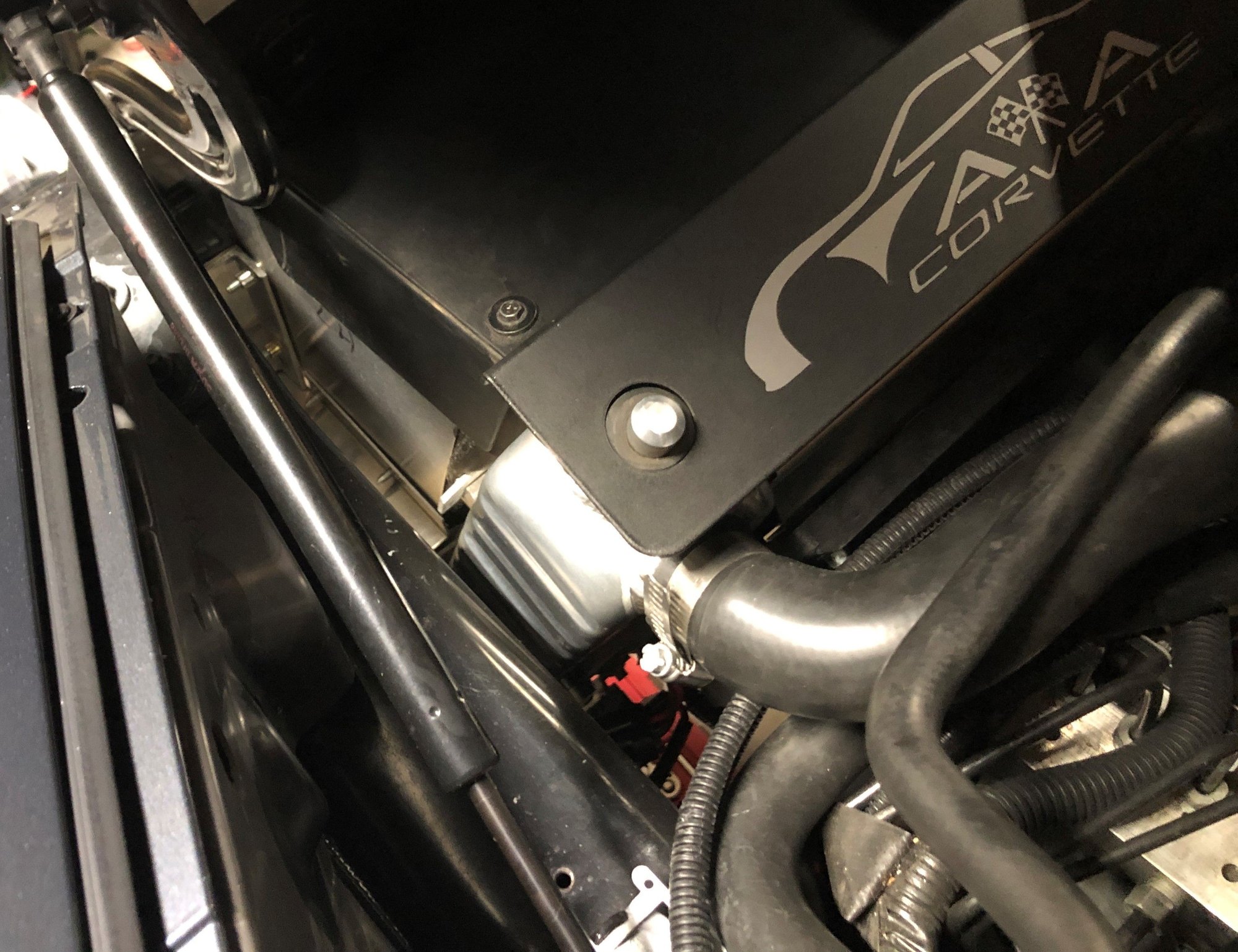

GM had a nice shroud that brought cool air into the condenser & radiator. One of the first things to go when you install an air to air intercooler in front of the radiator is that shroud. The shroud helps prevent pulling hot air from the engine compartment back through the front of the radiator. I made some panels to keep that to a minimum. It has made the biggest improvement to date. Do what you can to seal the front of the radiator from "recycling" hot air.
I have the full size dewitts radiator and two extreme fans in the dual spal shroud. I used two stock fan modules, one for each fan due to amp draw. I would go with the Prospeed fan shroud today but they were not available back when I did everything.

Would you mind throwing up some pics of your handy work if you get a chance? Wouldnít mind seeing how you boxed everything in if itís not to much trouble

Here you go. In the middle of intercooler project so the front end is off anyway. I think these side panels made the most improvement, but I did some stuff down below as well. Basically make a couple panels that goes between the front crossbar and the radiator. What I saw was the car runs a lot cooler and the fans run alot less.
Realcanuk; Would love to see how you did it. I'm having a hard time picturing it. My shroud is long gone.
Left Side
Right Side
Left Side
Left side diff angle
RPOWU8 is offline
