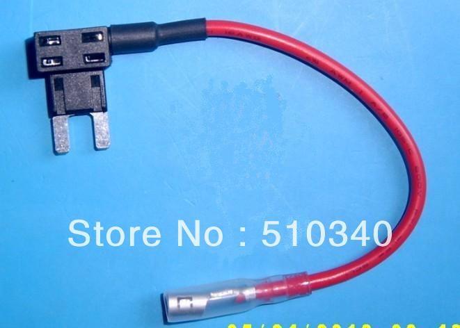

buy a fuse tap , connect it to one of the fuses on the passenger side footwell fuse panel (DRV or PASS heated seat fuse) and run the wire to your hardwire kit.
Remove the DRV Heated seat fuse, install that fuse in the original fuse slot, place a 10 A fuse for the wire going to your hardwire kit, then plug the fuse tap in the DRV heated seat fuse slot.
You will have to run wire from the fuse tap to the location of your hardwire kit. the fuse tap has a wire connector on the wire end.
Using the fuse tap at the DRV heated seat, the power will only come on once the car is started.

For clarification on what was posted above:
-buy a fuse tap
- pull the drivers or passengers heated seat fuse
-plug that fuse into the lower of the two levels of the fuse tap (power is restored to heated seat)
-buy a new 10A fuse and plug it into the upper of the two levels of the fuse tap. (This fuse now controls power to the radar detector .)
-plug the fuse tap into the slot where the original heated seat fuse used to be in the fuse panel
-tap wire on fuse tap for power that will only come on when the car is started (what I need!)
I think I'm understanding your post but wanted to double check so please let me know if I've got it right. This is a great idea thanks for posting. I'd much rather go this route than tap a random wire !!
Thanks again!

You got it....it will work like a charm for you and the wire can be hidden under your dash
