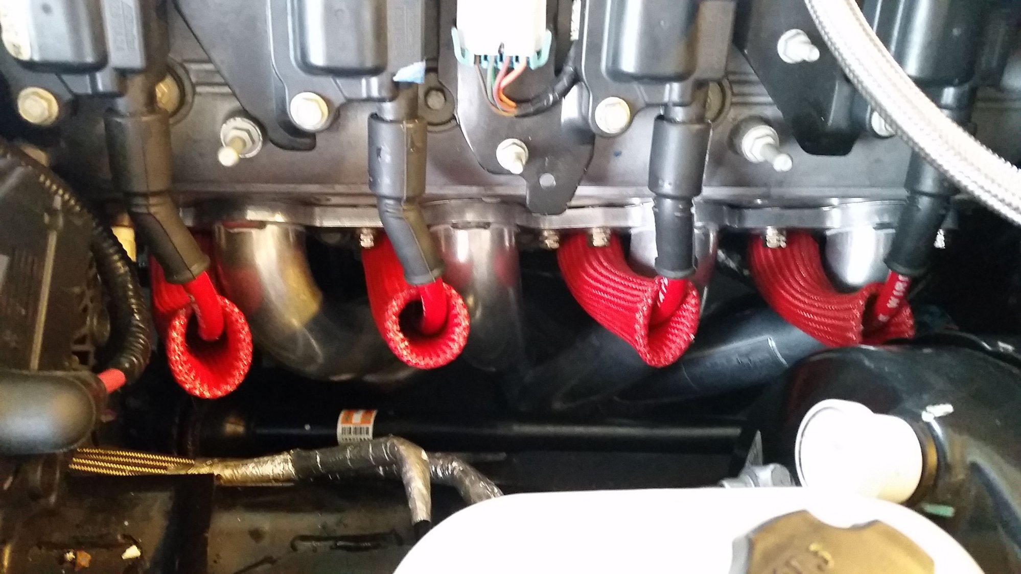

Not tube Dia, but flange that matters. With Kooks headers I used OEM gaskets and stage 8 bolts. (French locks) of sorts
G.M. gaskets much better Quality than Kooks gaskets.
Have to look hard at pic, but they are there .........
