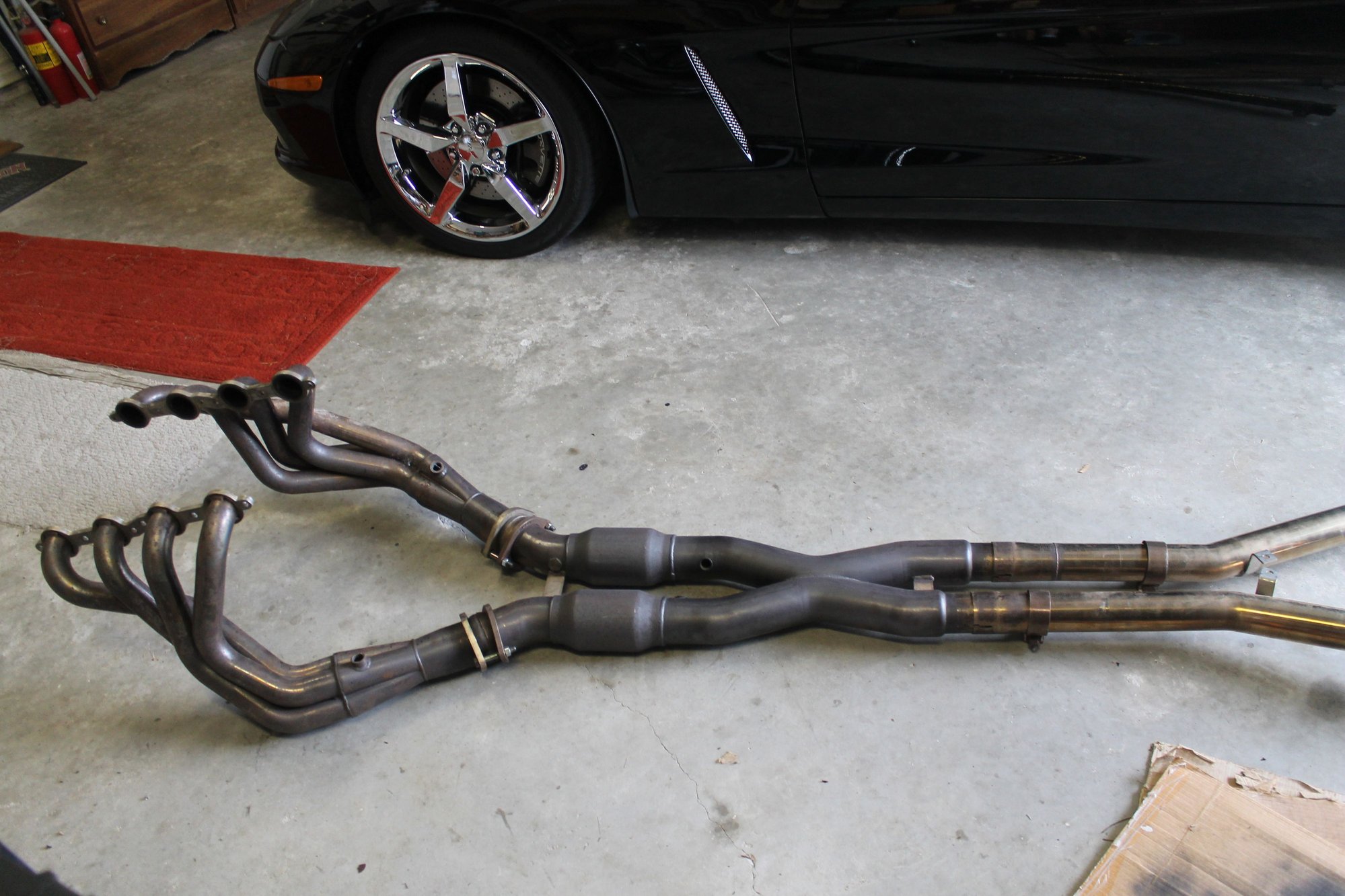

Here's a pic of my Kooks LTs with HF Cats & X Pipe, they bolted right up to the factory NPP (Axle Back.)
Kooks 1 3/4" with HF Cats.
