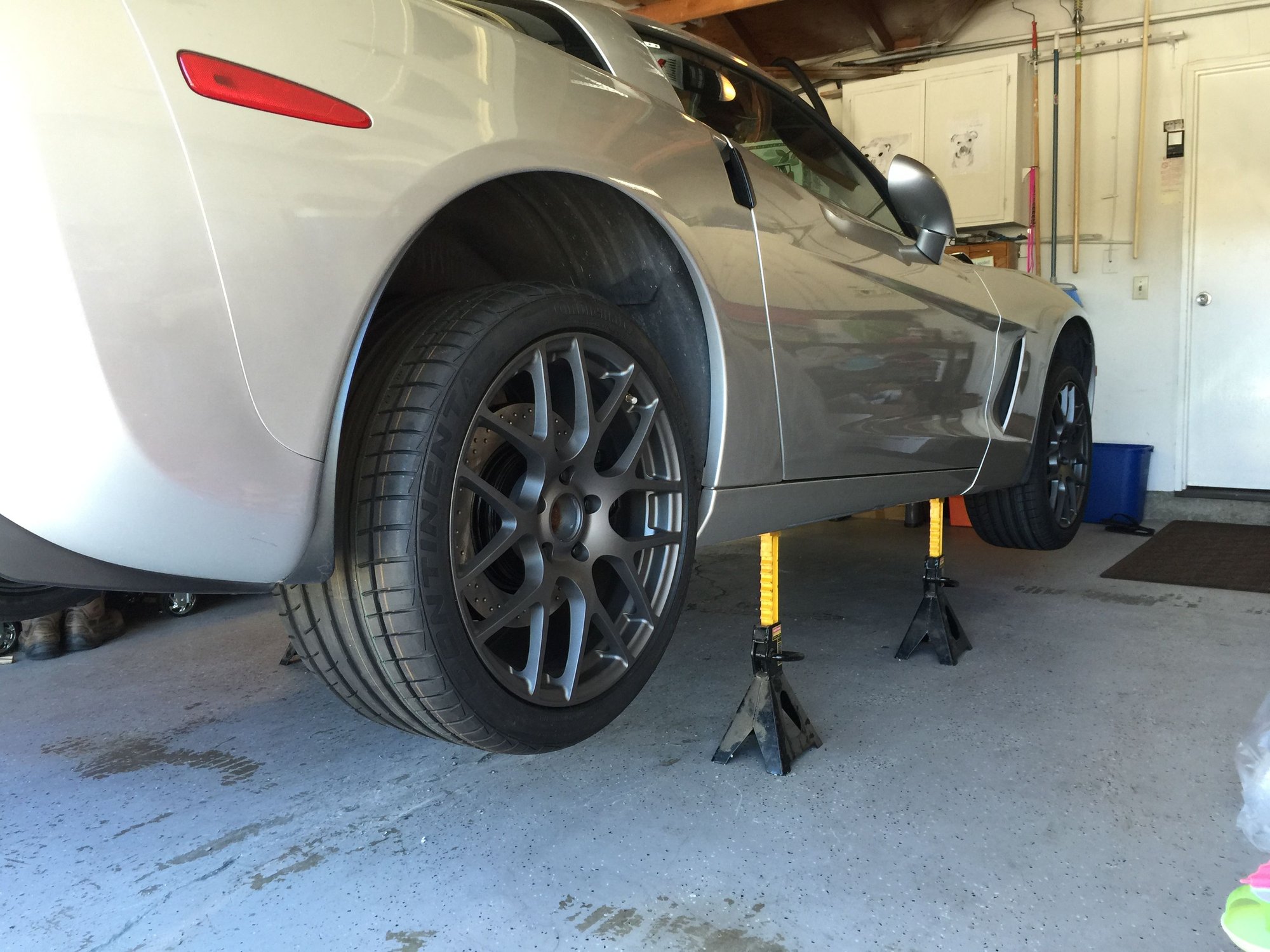

For sure it's doable on jack stands. I've done numerous clutch jobs, engine swaps, header, cam, heads and countless mods on jack stands.

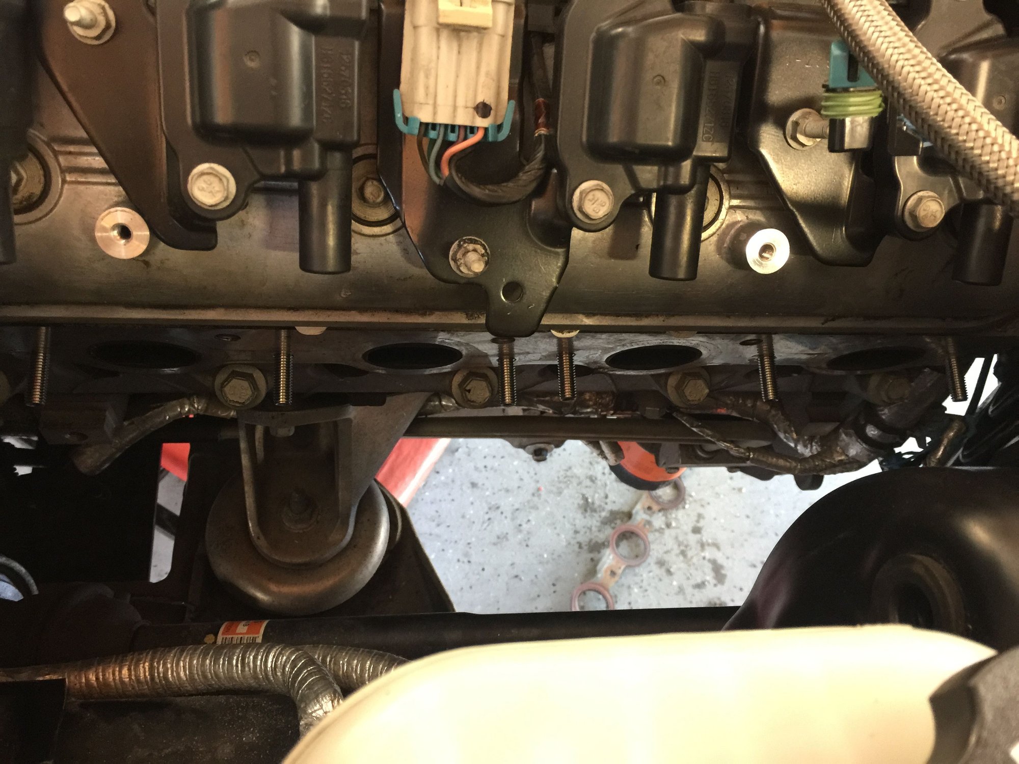

I forgot to say that if I were to do another header install on my Vette, and had to do it alone, I would try to get a set of studs, (as shown in the second picture posted by Brandon619 in post #5 above) rather than reusing the stock or aftermarket header bolts, or at least use a couple of short studs as "dowels", as that would make it much easier to hang the header in place and keep it aligned, because hanging the header and getting the nut started is much easier than holding the header in place and trying to start threading a bolt into a hole that might be difficult or impossible to see.
