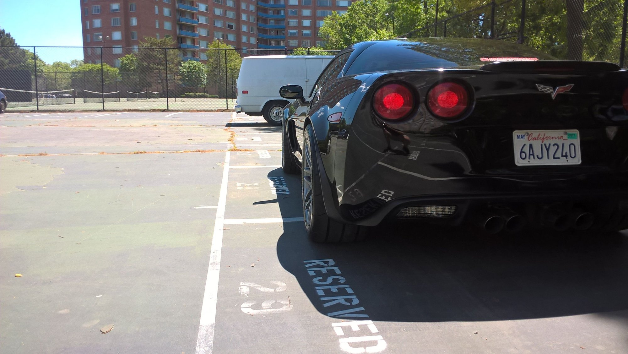

Forgestars are a good, cheap option. Running F14s with the same size rears. 18x12 with offset of 50.

They're deep concave. This setup works well for me on the street. Hooks power fairly well at 837whp and is a nicer ride than stock. Will probably need new set of rear tires each year to maintain traction, but that's expected at my power level.
Most guys run 17x11 with the Welds and not 18s like you're looking for, but I believe 18x11s are available.

No spacers and fitment is perfect.

Most run the Welds with M&H 325/45/17s, which are listed as a 28" tall tire compared to 27.8" for the MTs. They both measure less when on the car, but are similar in height.
