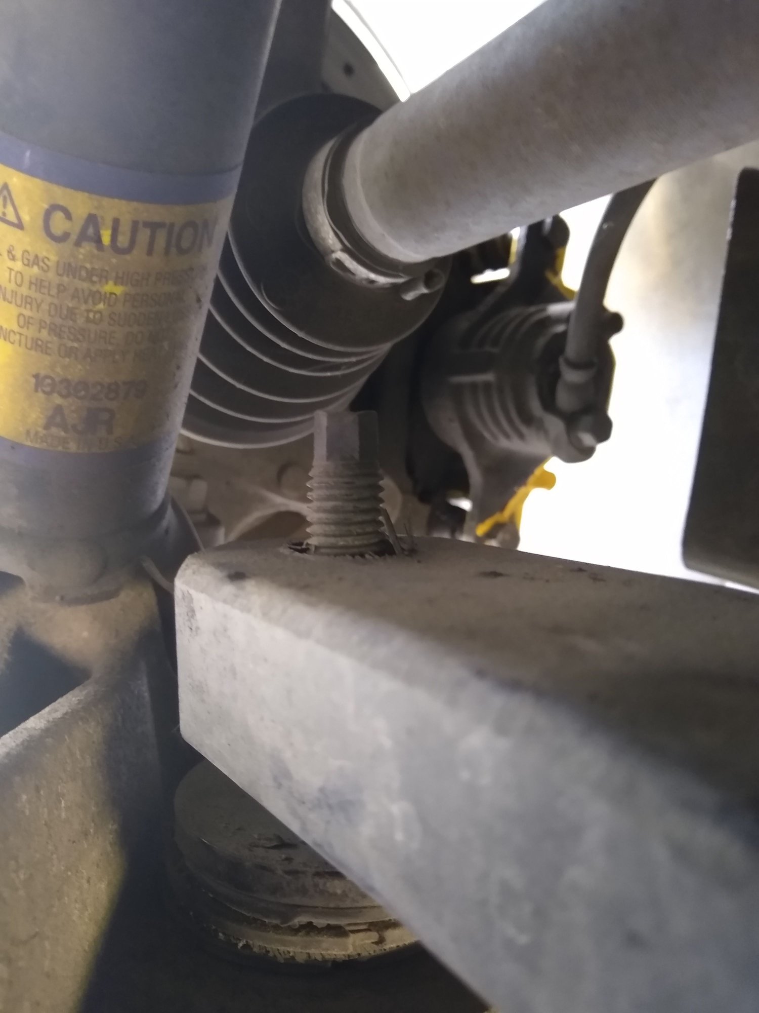

Old Aug 21, 2019 | 08:38 PM
OregonMike's Avatar
OregonMike
Joined: Jun 2017
Posts: 689
Likes: 98
From: Eugene Oregon
Here's what's in there now. I'll do some searching on lowering to see if I can find a post with stock & lowered from near the same angle.
Old Aug 22, 2019 | 08:02 AM
Cockroach's Avatar
Cockroach
Joined: Feb 2017
Posts: 942
Likes: 171
Those are the factory bolts, I doubt that is your issue but if you support the suspension and then jack up one end at a time on the leaf you will make a gap under the pad to squirt a small dab of grease. Worth a shot as it only take a few minutes.
