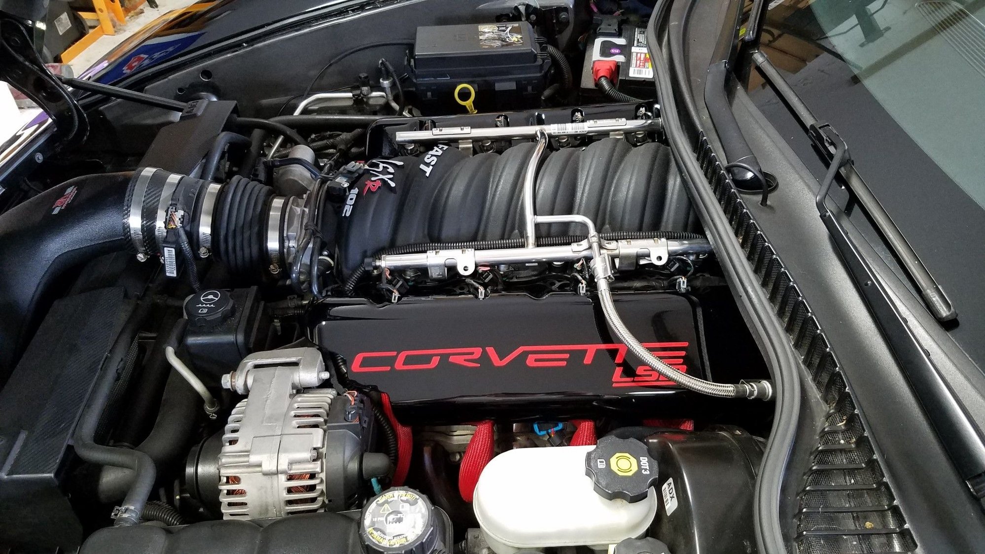

Not sure how that happened. I believe i used the LS1/LS6 hardware, I figured it was the same (it doesn't say) and it was. Works perfect without modification.
Originally Posted by Shikaitsu
I had also looked into Holley rails but I could only find part numbers for LS1/LS6 and LS3 so I wrote that off the list. I should also mention I'm using LS2 style FIC 100lbs injectors if that makes a difference.
Like said earlier, the LS1/LS6 intakes are the same as the LS2 installation wise.... Its what I use but the downside to them is they scratch really easy. As long as your injectors are LS2 height, treat them as stock for the purpose of install. This is the best photo I have, before I finished tidying up all my wiring.
