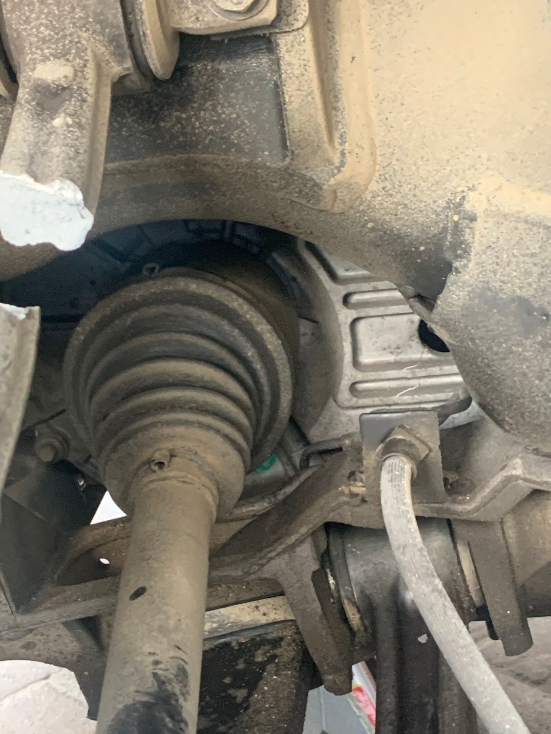

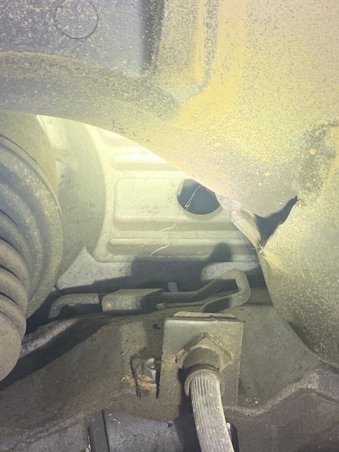

Hi guys!
I got a salvaged 2009 Z06 from my buddy (hit a divider). As i was inspecting the damage which included radiator, fan, lower and upper radiator support, rear right wheel, upper control arm and shock along with other minor things.
All that can be replaced but I noticed the right Differential Cover was cracked. The actual cover is not damaged but the webbing where it connects to a mount is cracked.
Doesn't seem like a tough cover to get off. Would I be able to get this welded without any issues in the future?
Or should I get a new cover? Which would require shimming.

The cover can be welded, but it's gonna take a fair amount of filler, and might not be as strong when it's done. Might also distort some, so that needs watched.
FYI, when I had mine apart this spring, I had to replace several of the side cover bolts because when torquing back to 18ft lb or whatever it was, several stretched and broke. They're garbage, and probably TTY bolts for all I know.

Don't quote me on this but I want to say the tolerance on that depth is only around .003. So, not a whole lot. I'd measure very carefully. If the cracks could cause a bad measurement, I'd probably opt to getting a used rear for it and call it a day. I was looking at my pics and I don't really have any good ones to remind me what mine looked like. Where yours is cracked I want to think ins't a critical area. TIG weld that thing and see how it holds up. Gonna have to cut pretty deep to get a good bead down in there. Would prefer someone with experience in welding those, not for the weld, but for the understanding of what else might go wrong after it's heated. Hopefully there's no effect on the rear end.

I welded one for my customer who spun into the wall @ Fontana speedway at a buck fidy, We didn't pull the diff, just dropped the cradle. Would have been much easier with the diff out & on the bench, that being said he's still racing it to this day wit 0 problems.
WELD IT!

With a impact that was able to crack the mount, do you think there is any internal problems?
Doubt it, the mounts are a definite week area.
