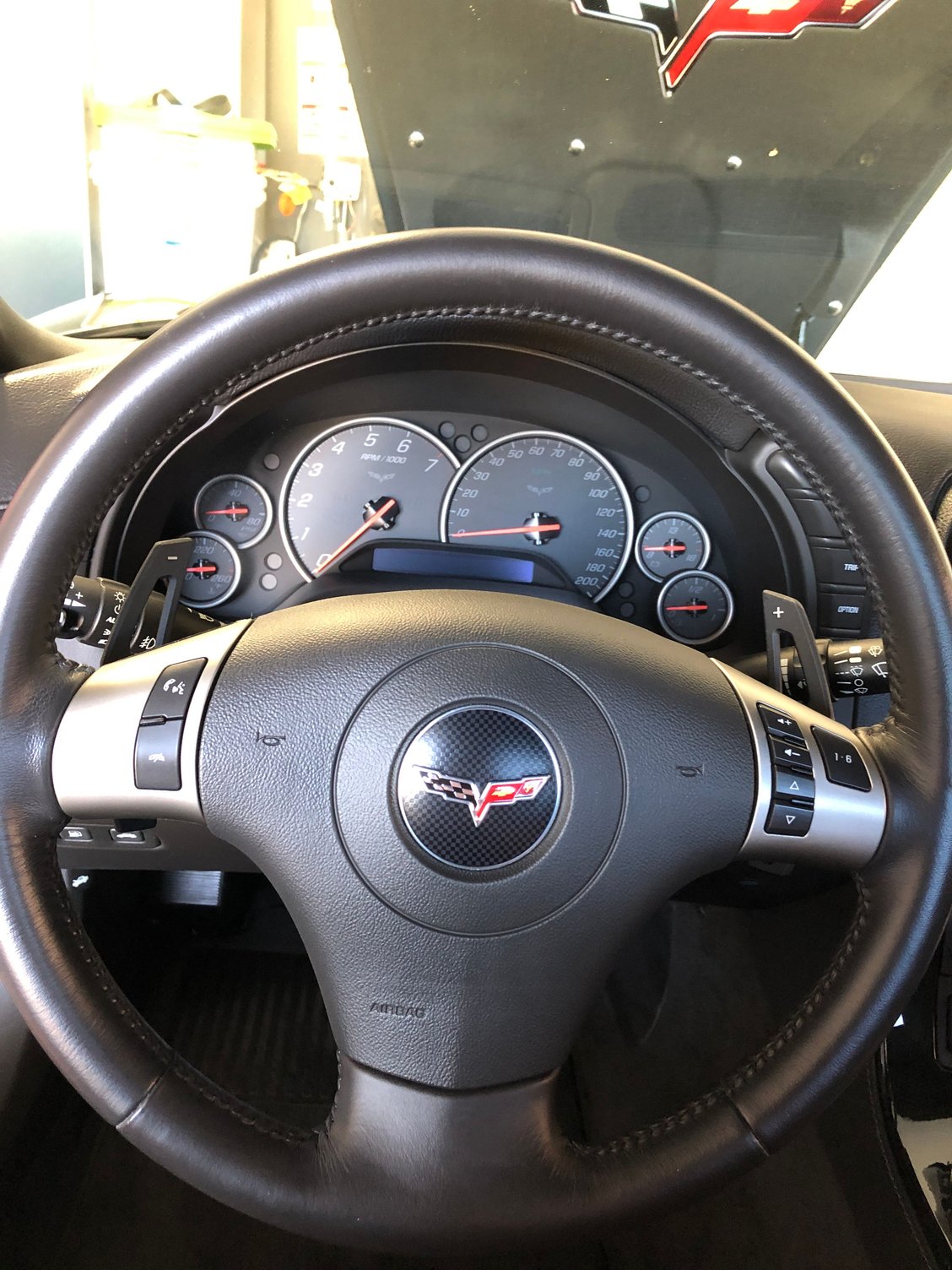

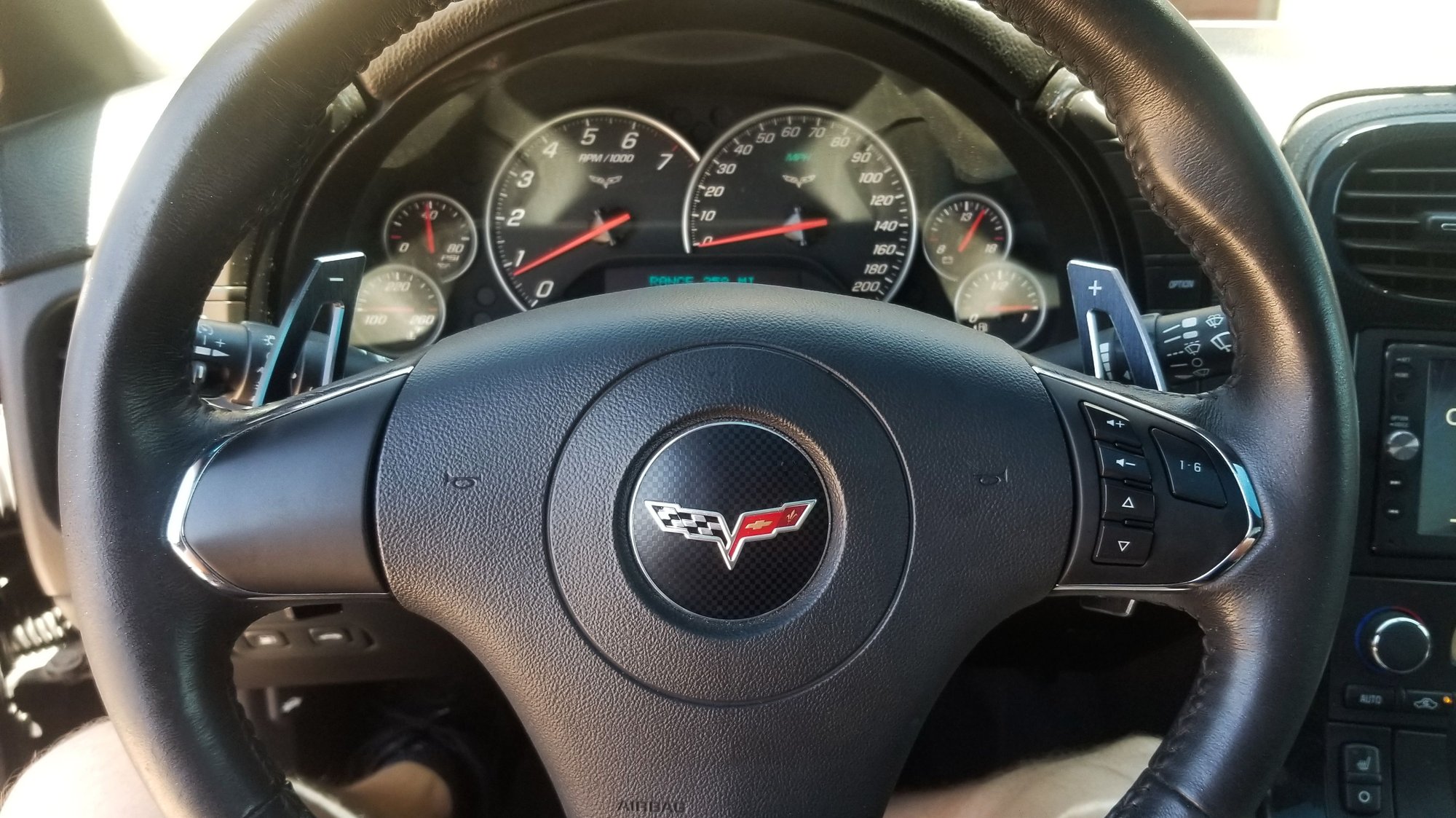

I've done the F1 paddle shift Mod, and I made those up and down stickers to put over the paddle + signs.
Having said that, I just ordered the adapters so as to install new paddles on my steering wheel.
Here is what they will look like. I did receive both in the mail, but the adapters were sent to my US address, so I have not picked those up yet. I did get the paddles sent to my home in Canada, so I do have those.
If you want the stickers for the paddles, I can certainly help you there.
If you want more info on the new paddles and adapters, then PM me for that info.
I can make the paddle arrows Up or arrow Down on whatever paddles you want them on as per the PDF
I put these on water resistant labels, then cut them out per the outline and they fit perfectly on the OEM paddle (+) or (-)

Bought the adaptors and new paddles too. Doing the wire switch and new paddles over the winter.

I bought my adapters off a forum member here that 3D printed them, then I bought VWgti paddle shifters on Amazon for 20 bucks, did the wiring switch while I was in there and LOVE the way it all works now....

Same here. Only $50 total and a little time.
