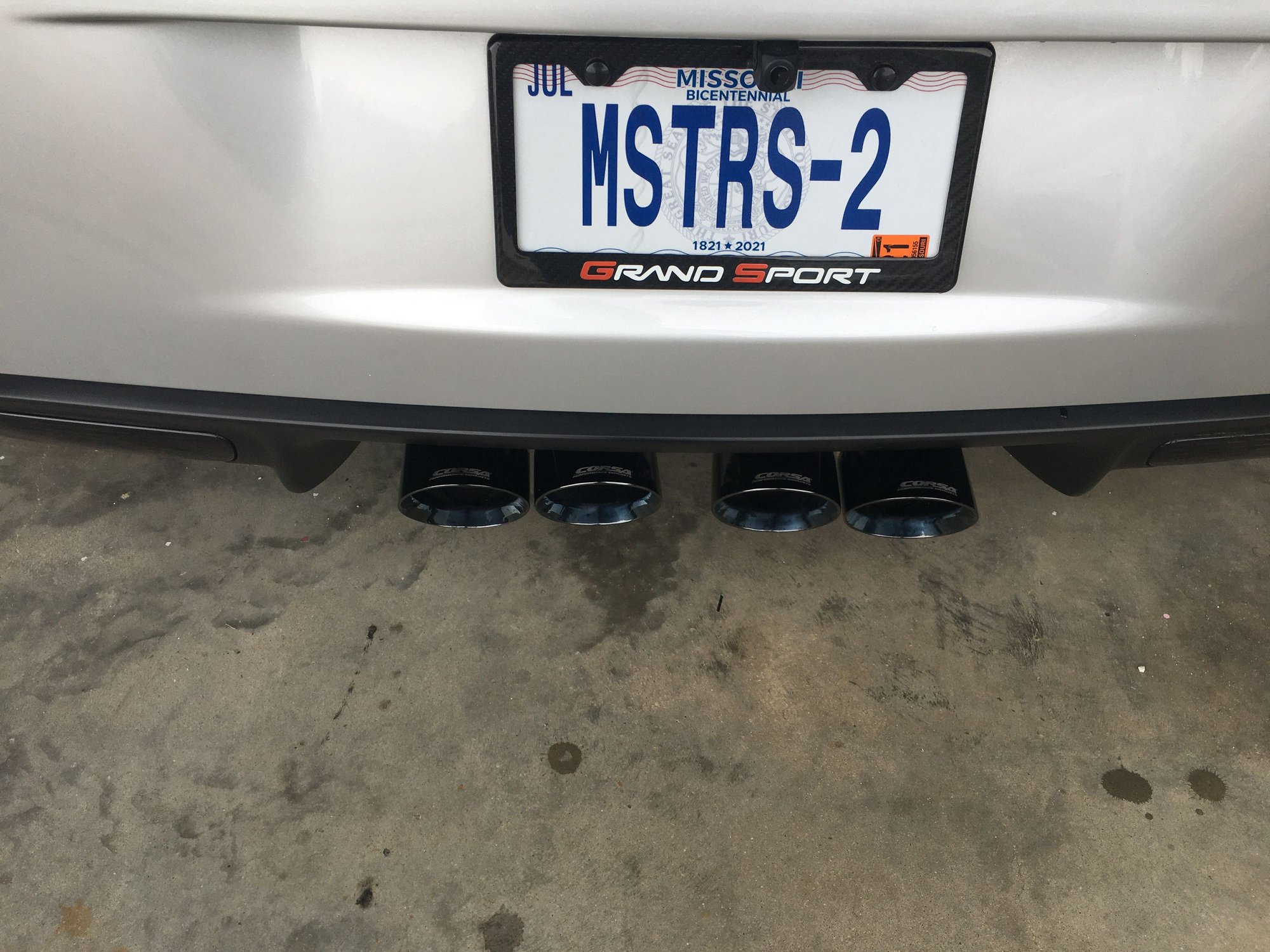

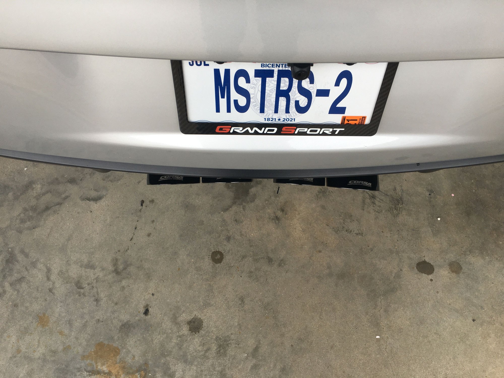

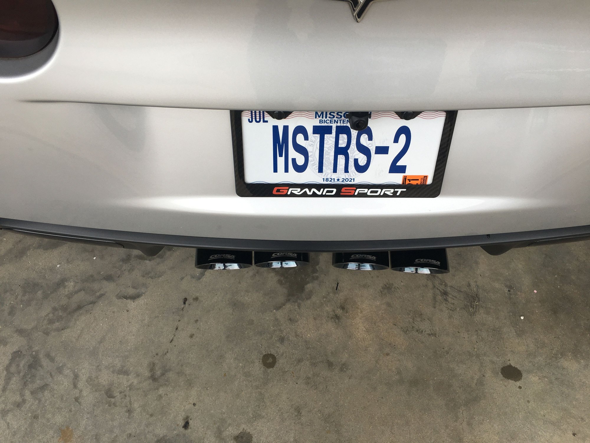

I put my new corsa extreme exhaust on last night...it was horrible to say the least lol. Anyways, I am not sure if the tips are supposed to be angled like this or not? I messed with it for several hours and could not get them to angle any different. The car already has unknown headers and off road x pipe. Anyone know if this is correct figment or if I just suck at this as bad as I think I do 🤣. The driver side isn’t sticking out as far as the passenger...but that’s not my biggest concern...it’s the angle that is throwing me off. Also, the mufflers are correct for each side. I checked and checked and checked to make sure driver muffler was on driver side.

Unfortunately, I think you answered your own question. Unknown headers....unknown x-pipe.....all it takes is a very few degrees out of alignment at the header or mid-pipe for the muffler tips to be out of alignment. You might try loosening all the connections starting at the header collector & try to get all the pieces to line up properly. Good luck....
