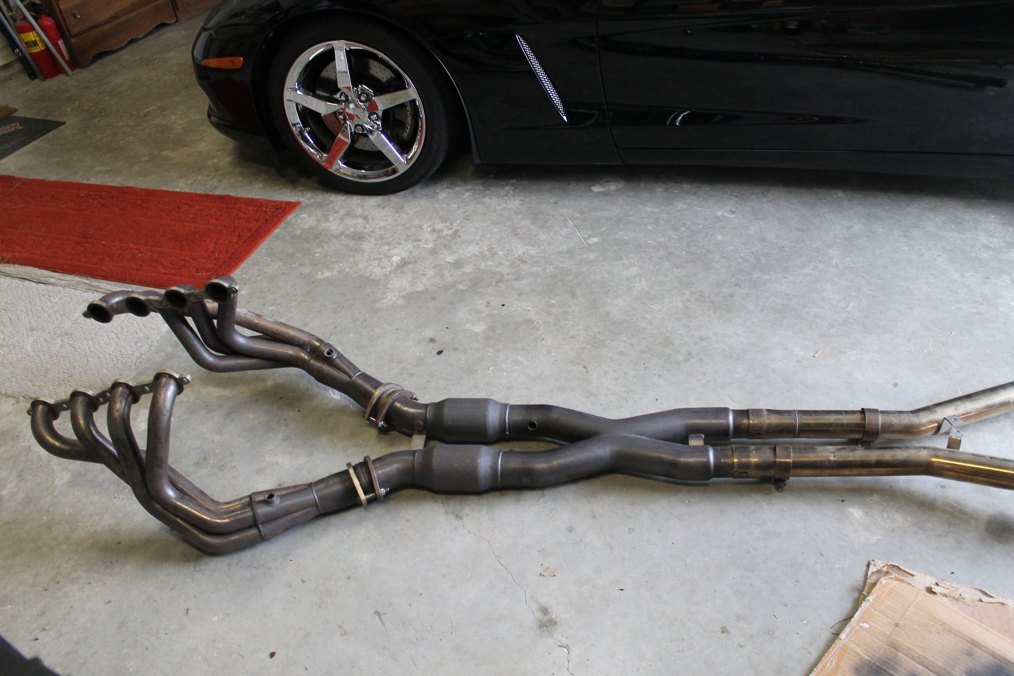

My set is quite a few years old, 3" catted in the front and necks down to 2 1/2" in the back:

Kooks x pipes are 3" but they neck down to 2.5" before the mufflers unless you get one for a Z06/ZR1. This is the one you want https://kooksheaders.com/exhaust/cro...onnects-to-oem. You'll notice it says 3", but also says connects to OEM. And in the pic you can see where it necks down before the mufflers
Nice! Yea that’s what I’m wanting. Wanna sell me those? Lol
