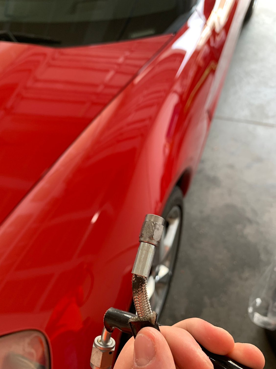

So I recently blew my diff (typical 05 problems) and did a RPM diff, tick performance trans, and LS7 clutch. I picked up the tick adjustable clutch master and long line kit since it would be accessible but once installed, the length of the crimp on the line is so long that the torque tube will not fit in the tunnel. Has anyone else had this problem? I ended up copping out for the factory line and now my headers burned they the rubber hose. I know it’s not backwards because the line has 2 different sized threads, and one being the size for the slave side. Maybe TICK has different lines for different cars and I got the wrong one?

You got the wrong one, and the one piece Tick fluid line will route the same way as the factory lines, and will have just enough line to bolt both sides in.
Also, make sure you pick up a remote bleeder line to install as well.

I know the line that I had was the fluid line. I just didn’t know if it was a universal line or specific with a C6. I did install the remote bleeder as well. The slave cylinder side was just too long. I’m the pic I took you can see how far bent the line is and that’s with it not even close to fitting in the tunnel
