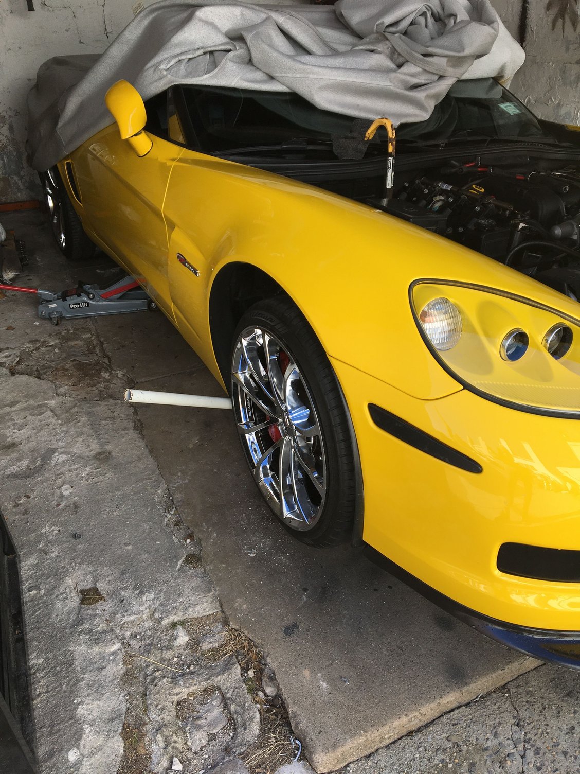

07 Z06 with LG headers....Took passenger side exhaust manifold gasket out...No way am I getting these bolts to line up again...I’m a one man operation as of now..
Any suggestions ? Disconnect collector ? Never attempted that before...

I'd disconnect the 2 bolts at the collector as it's probably preventing you from mating the header flange flat against the head.

Put a jack on the collector under the car to keep the tension off and you should be able to line the flanges up and get your bolts in. Worked for me

Yeah let’s hope I can get one of my jacks under there..The work area in my garage is the equivalent of a closet ...

Quick question..I’m only doing passenger side...If I put the jack under the passenger collector will it stabilize it enough because the drivers side is still connected ...Drivers side I’m not even going to attempt because the E85 fuel lines are in the way and I’m not sure how to disconnect...Besides there seems to be no discoloration near the pipes..

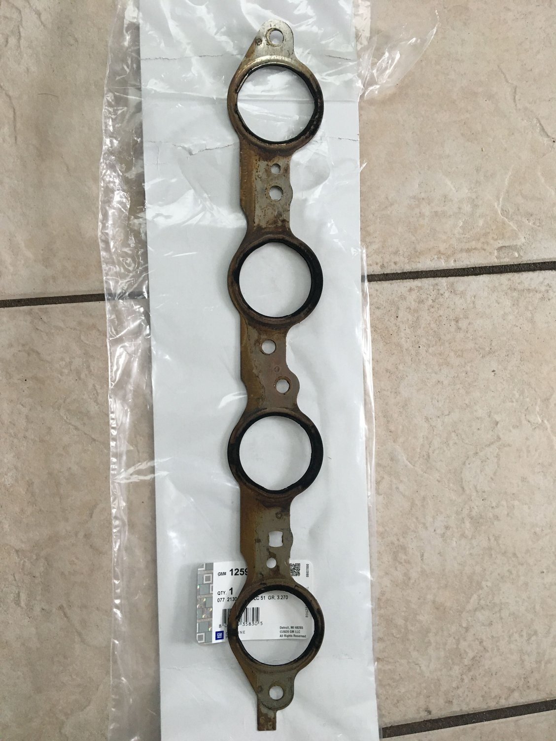

Ok great ....Next dumb *** question..Just got the gaskets in the mail, went with felpro....Does it matter what side goes against the heads ?

Look closely for directional markings on them, if there are no markings then it doesn’t matter which way they go on.

With the two offset center holes it can only go one way. QEM would have been a better choice.

oh yea good point didn’t think about that. I agree tho the mls oem gaskets are hard to beat. I would only use a thicker gasket if I knew I had a warped flange.

Ok done..Used the jack and a crow bar a little to get these bolts on...Didn’t want to cross thread...So should be good..Thanks for the tips..
