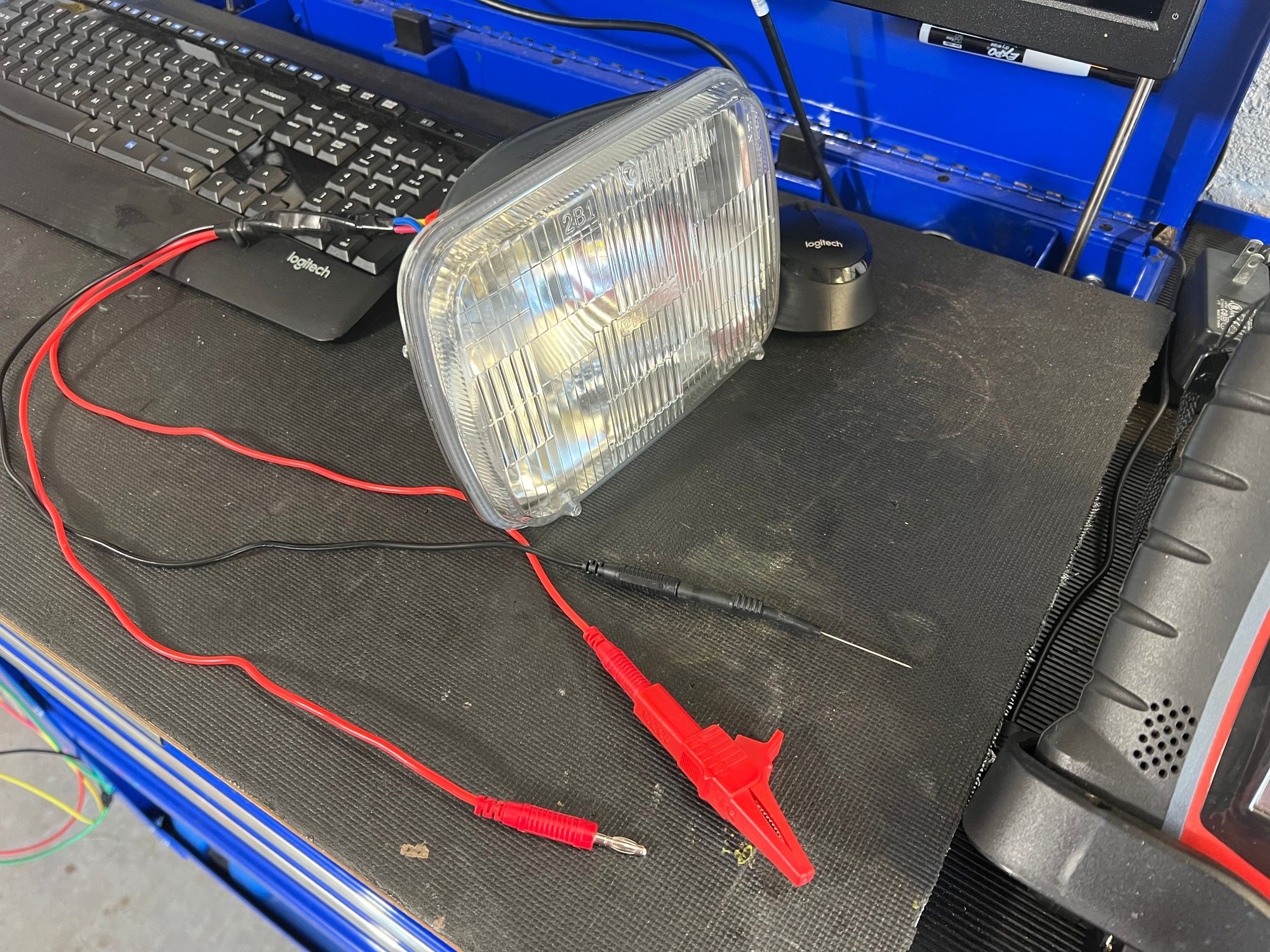

Was the module you replaced OEM or aftermarket ??…you’ll have to check all the wiring at the module to diagnose this accurately…can you also edit your profile so we know what model year and any other relevant info…mods, tune, etc…and as far as checking wiring let’s say you are checking the power to the fan (red wire) so you have to make sure that the circuit can carry the current…I use headlight bulbs of various amperages so if the fan say draws 5 amps I use a 5 amp bulb and if I connect it to the red wire and the bulb is bright I know that wire can supply the current to the fan…only checking for 12 volts is not the way to do it…it’s the same on the ground side.

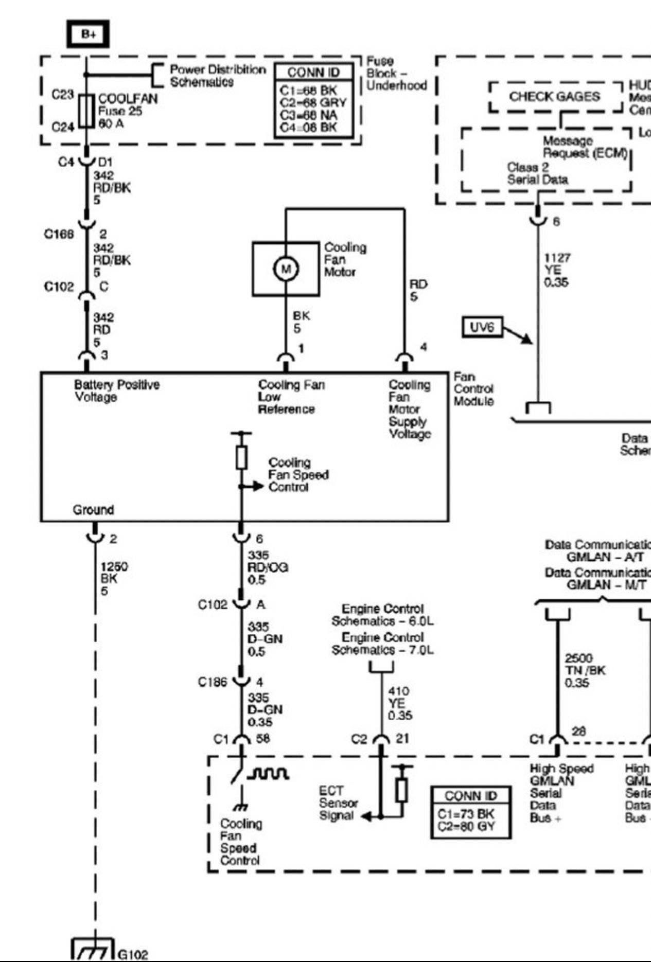

There is no relay in the cooling fan circuit…wiring diagram above.
