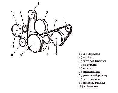

Happy New Year to everyone,
I have a DIC message to say Service Charging System on my 2008 Callaway Corvette (mileage only 15k kms). The battery and alternator have been exchanged about a year ago so I think the engine belt either needs adjusting or replacing. So I’d appreciate some advice on how to adjust the belt to see if that resolves the problem......thanks in anticipation SpanishMike.

The belts are self adjusting with the drive belt tensioner, and the AC belt with the AC tensioner. Look at them to see if they are at their max tension. Your belts may be stretched so as the tensioner can no longer take up the slack of the belt.
